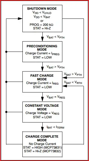

Most modern phones have a charging control circuit which takes care of what you are proposing. When the battery is charged, the charge control IC will terminate charging of the battery, then monitor to see if it needs charging again. So all the charger has to do is make the power available.
Below is a flowchart from the datasheet of MCP73831 Li-Ion charge controller IC from Microchip:
MCP78131
You can see the various stages of the charge cycle. This is a pretty basic IC (I just picked it since I've used it a few times) but does the job and is nice and cheap - many phones will have a pretty complex power management IC, possibly a custom one.

    Thanks for taking time to answer my question. This is precisely what I was hoping to hear. Now, is there something that one can observe and determine, without ripping a phone model apart, if they do have such power management IC's. For all the mobile phones I've come across, I've been disappointed to find that the "battery-charging" animated icon starts showing activity, on being plugged-in, indicating that they lack such intelligence to prolong battery life! – bdutta74 Jul 22 '12 at 07:27
    You could rig up a little test jig to put your multimeter in series with charger and phone to measure/plot charge current. If it's something like the above you should be able to see the various stages, eventually dropping to 0A (or a very low value of leakage current, e.g. ~1uA or so) Either that or see if you can find a teardown of your phone, check what PMIC it uses and refer to the datasheet. – Oli Glaser Jul 22 '12 at 08:08
