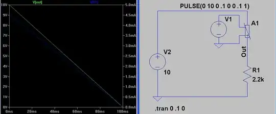

Use the SpecialFunctions/Varistor.asy component with a time-varying voltage source
Screenshot

  • +1 Thanks, Its not how I remember doing it but It should do the trick. I won't mark this approved just yet I like to see if anyone has any alternatives..(although it doesn't look likely...) – volting Jul 20 '10 at 15:29
    There are plenty of alternatives - You could use a transistor with a known Rds characteristic, and change the gate voltage from 0 to saturation, or just put in a voltage or current source and ramp through the voltage or current range that you want to establish across your resistor. The varistor, however, is the controllable resistor you asked for. – Kevin Vermeer Jul 20 '10 at 16:35
  • Sure.. but if my memory serves me correctly(which it probably doesn't) it is possible to do it with a regular resistor + some simulation command, which would be more intuitive and straight forward. Anyway Thanks again for the suggestions – volting Jul 20 '10 at 18:19
  • Use the source, Luke! Open up the varistor model definition and subcircuit, and figure out what it does - The SPICE commands should be in there somewhere. This document: http://ltspice.linear.com/software/scad3.pdf should help you. – Kevin Vermeer Jul 20 '10 at 19:20
  • Point taken! It came to me... what I used before was a parametric sweep – volting Jul 20 '10 at 20:22
  • This solution doesn't appear to set the resistance, rather it sets the voltage drop over it. It doesn't seem to be any different to just placing a voltage source in place of the varistor, except that the varistor will never drop more voltage than what is being supplied – JolonB Nov 26 '20 at 20:06
  • @JolonB Not true: it sets the threshold when the varistor starts conducting, and its conduction is given by the parameter `Rclamp`. The effective resistance will be `Rclamp + V(+,-)`, e.g. with the default `Rclamp=1` and a 3 V controlling voltage, the resistance will be 4 Ohms. It's easy to set up a current source with 1 A across a varistor, and let's say a voltage source as the control with `SIN(1 1 1)`. Simulate with `.TRAN 1` and you'll get a sine varying from 1 V to 3 V (2 Vpp + default Rclamp). – a concerned citizen Oct 19 '21 at 15:40
