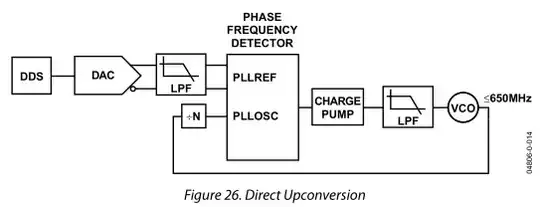

Is there anything I forget? The AD9956 is a 400 MHz DDS system but claims:
The AD9956 uses advanced DDS technology, an internal high speed, high performance DAC, and an advanced phase frequency detector/charge pump combination, which, when used with an external VCO, enables the synthesis of digitally programmable, frequency-agile analog output sinusoidal wave- forms up to 2.7 GHz
Two application circuits are given in the datasheet:
but I do not understand them. What would be the switching time from, say 1.6 to 2.4 GHz for these?

Two application circuits are given in the [AD9566] datasheet... What would be the switching time from, say 1.6 to 2.4 GHz for these?
Those are both essentially PLL schemes. The switching time will be limited by the bandwidth of the loop filter. I'd expect it to be difficult to get it below a several 10's of ns. Although 50 ns doesn't seem totally out of the question if the loop bandwidth can be as high as 20 MHz. (This also applies to your proposal of a straight PLL solution)

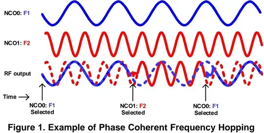

The frequency produced can maintain phase in two different ways:
  • Each frequency can maintain phase coherency to itself (upon switching back to the frequency it will be phase coherent), that produces a much wider bandwidth and possibly unwanted spurious content but allows each channel to resynchronize quicker when it is switched to.
    A use case for that would be one transmitter and multiple receivers, such as a cell tower, each receiver doesn't want to have to resynchronize when the transmitter comes back to it's channel.
  • The output frequency produced can transition smoothly and continuously, producing no spurious content and maintaining the narrowest possible bandwidth. A frequency change (of the carrier) must be differentiated from a temporary phase or frequency change, as would occur from modulation.
    A use case for that would be one or more transmitters (such as occurs with single channel simucasting, or Project 25 trunking simulcast) communicating with one or more receivers on a spread spectrum channel (not used in P25, but used by other protocols). Maintaining as small a bandwidth as possible while switching 100's of thousands of times per second allows the transmitted signal to sit beneath the noise floor.
Figure 1 - Example of Phase Coherent Frequency Hopping
Figure 2 - Example of Phase Continuous Frequency Hopping Image source: "Evaluating the frequency hopping capability of the AFE74xx"
