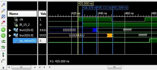

Armed with this knowledge I run a post-Place-and-Route simulation with a 10ns clock period thinking everything will be fine. However, it is not. The signals do not settle in time for the next clock edge and everything is a mess. Relaxing the clock to 50ns (20Mhz) allows plenty of time for everything to settle.
timings
At 425ns we get the clock pulse that signals the start of the cycle in which we will execute the instruction SP <- 0xFFFFFFFF. IR_15_2 is the signal from the timing report. SP_value is a register, so it only assumes the value presented to it on the next rising edge. SP is loaded from bus3 so we use that as a proxy.
In the graph we see that it takes 3ns or so for IR_15_2 to be asserted at all. Then it takes over 10ns more for the signal to be taken over by bus1. At 451ns, a full 26ns later, the signal is available on bus3 and we can start thinking about loading SP with it.

Static timing tell me that the path longest register-to-register path in the design should take about 4ns, whereas the simulation shows that the signals take about 26ns to settle. What is going on here? Is the static timing analysis not finding all relevant paths? Did I use/configure the simulator wrong? Did I misread the static timing analysis?

    Why is bus3 indicating `UUUUUUUU`? Is this the first instruction that you run, or is there something else causing a `U` to propagate? I'm not sure how STA handles `U`, and that may be part of your problem. – W5VO Jul 19 '12 at 18:43
  • It's the first actual instruction we're running. After the reset pulse (not shown) I run three nops (tristate everything) to make sure the effects of the reset have died down and then I run this instruction (to initializew the stack pointer). The UUUUUUUU on bus3 is the result of performing ALU operation 0 (and, i believe) on two ZZZZZZZZ inputs. – drxzcl Jul 19 '12 at 18:46
  • BTW, the timings shown in the graph are typical for all register->bus1->bus3->register cycles. This also holds when there are no UUUUUUUUs in sight. I just picked this instruction because it pops up as the slowest path in the STA. – drxzcl Jul 19 '12 at 18:48
    It looks like you are reading the timing report correctly, so that narrows it down to (most likely) that your STA setup doesn't match your operating conditions. For example, a default STA assumption may be that all inputs are stable (defined as 1 or 0) at the rising clock edge. Is there a feedback loop that only shows up when some buses are `Z` or `U`? – W5VO Jul 19 '12 at 19:01
    Incidentally, are you really sure you need tri-state? That alone can cause a lot of grief in STA. – W5VO Jul 19 '12 at 19:05
  • Oh, I see. You mean have the decoder assign the signals directly in HDL ("if sel=x"1" then bus1<=register1; end if;") and have synthesis worry about the wires instead of messing around with "fake wiring" that is explicitly put to "Z". It never even crossed my mind. I'll have a look. – drxzcl Jul 19 '12 at 19:12
    In my experience, internal `Z`'s should be treated as a hammer - useful in specific instances, but not a miracle fix or even a preferred solution. – W5VO Jul 19 '12 at 19:18
  • I changed my code to never-ever output a Z (I went so far as to scrutiny all the Z characters in my source files). This made a small impact in the STA output (3ns slack instead of 6ns) and a huge impact in the simulation output. I can now run it with a 10ns clock and the output is consistent. It looks like you solved the problem! If you add it as an answer I'll accept it. – drxzcl Jul 19 '12 at 20:34
Looking through your timing report, there is nothing that indicates a potential issue. Since you have a problem, this means that the scenarios that static timing analysis (STA) is checking are not covering the actual usage of your circuit.
Without any serious setup of STA, some common assumptions are that all inputs are valid by the time the clock rises, and that all states are known (meaning a logic 1 or 0). Immediately, the UUUUUUUU on bus3 looks very suspicious, and is a possible issue with initialization. In logic simulations, U implies that the line is either a 1 or 0, but a register driving it was not initialized properly. This could cause the simulator to give weird answers until all registers are loaded or reset. However, this problem manifests itself in later cycles after all registers have been initialized.
The other potential issue is bus1 starts in a high impedance state (ZZZZZZZZ). Considering that tri-state is not usually assumed in timing analysis, this is the most likely source of the timing discrepancy. Tri-state conditions must be carefully coded into your STA tool in order for them to be considered. This can be a very difficult task, and is prone to error (incorrect programming, missed cases, etc.). I believe that programming in tri-state delays would most likely give you an accurate STA result that should match your simulation.
However, tri-state is usually a bad choice for on-chip communication for both ASICs and FPGAs. This ambiguity of STA reliability, potential for bus contention, and the uncertainty of drive strength requirements make tri-state more likely to cause problems than fix them. The safer method is to use a multiplexor to select which source "talks" to the bus, or partition the design differently. I would only use tri-state when I know it will solve more issues than it can cause.

  • I changed my code to never-ever output a Z (I went so far as to scrutiny all the Z characters in my source files). This made a small impact in the STA output (3ns slack instead of 6ns) and a huge impact in the simulation output. I can now run it with a 10ns clock and the output is consistent. – drxzcl Jul 19 '12 at 22:04
