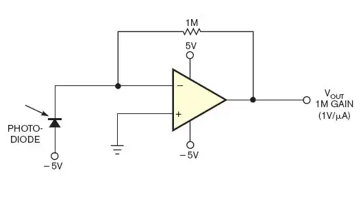

Oli used this circuit
in an answer, and it pops up a lot on Google images too. But does it work? If it does a theoretical explanation will be welcome.
stevenvh
  • 145,145
  • 455
  • 667
    Has anyone actually tried it? I've seen evolved circuits which make no sense but still work. – Rocketmagnet Jul 19 '12 at 08:58
  • @Rocketmagnet I just made the circuit and it works. It seems to work with diode pointed in either direction, but the schematic show provides better results (unless I forgot which side of LED is which). – AndrejaKo Jul 19 '12 at 12:07
  • @Rocketmagnet - I also tried it during discussing the [other question](http://electronics.stackexchange.com/questions/36080/specific-color-sensing-is-it-possible-in-an-economical-way-without-using-camer). Glad someone else actually confirmed it, thanks Andreja. – Oli Glaser Jul 19 '12 at 12:12
    I bet that most people who do it this way don't have a clue why it works. – Federico Russo Jul 19 '12 at 14:39

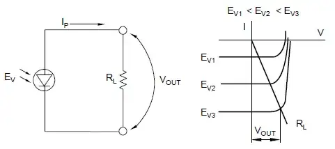

According to this, the photodiode does indeed produce a current even when there is zero volts across it; it's the short circuit current. Note that the reference direction of \$I_S\$ in the question's diagram is opposite that of the \$I_{SC}\$ of the diode so the output voltage is:
\$V_{OUT} = - I_S \cdot R_F = I_{SC} \cdot R_F\$
I found the above here.
A reasonable question to ask is how can a current be produced with zero voltage?
Remember that there's an internal E field through the depletion region even when the diode terminals are shorted together. Briefly, light generated EHPs in the vicinity of the depletion region are separated by the E field resulting in charge accumulating in the P and N sides (that's how \$V_{OC}\$ is developed). A short circuit allows a current to restore charge balance.
Alfred Centauri
  • 26,502
  • 63
  • +1 - it would explain a lot. I still want to keep some of my scepsis, though: a current and no voltage, wasn't that reserved for superconductors? BTW, could you give a link to the document where you found that? – stevenvh Jul 19 '12 at 12:06
  • @stevenvh, Thanks, and I added a link in my answer. Remember that there's an internal E field through the depletion region even when the diode terminals are shorted together. Briefly, light generated EHPs in the vicinity of the depletion region are *separated* by the E field resulting in charge accumulating in the P and N sides (that's *how* \$V_{OC}\$ is developed). A short circuit allows a current to restore charge balance. – Alfred Centauri Jul 19 '12 at 12:29
  • @Alfred Centauri, I do not see anything supernatural in that a true current source (the photodiode) produces current when shorted. What's more, this is its favorite state. I would be more surprised if a transistor could produce current since they model it by a current source:) – Circuit fantasist Dec 27 '19 at 08:21

The classic inverting amplifier is like this:
circuit
The photodiode will create a current, which will cause a voltage drop across the resistor. An opamp with negative feedback will try to make both inputs equal, so the inverting input will be at 0 V, and the current through the resistor will create a positive output voltage.
Why did I think the other circuit wouldn't work? If the diode creates a current you would suppose there's a voltage drop as well. Then the voltage at the inverting input would be higher than zero, and the opamp, trying to correct that, would see its output go all the way down to the negative rail.
Alfred's graph shows however that the input can be driven down to 0 V by the output. It requires that the voltage across the diode can go down to zero, while there's still current. Here's another graph, from this document, which confirms Alfred's answer:
stevenvh
  • 145,145
  • 455
  • 667
  • An LED in reverse + light creates a negative current from cathode to anode, so the opamp produces a positive current = voltage across the resistor to compensate. – Oli Glaser Jul 19 '12 at 08:50
  • @Oli - yes, that's what I'm saying in the answer too. But does it also apply to the circuit in the question. The output will go *down* if the inverting input > the non-inverting input. – stevenvh Jul 19 '12 at 08:53
  • I see - yes, it should down if the LED is the other way round so you need a dual rail. I just confirmed this with my setup. – Oli Glaser Jul 19 '12 at 09:07
  • I'll have to give this a -1, since the circuit clearly works. The opamp is interested in equalising the current generated by the diode. It only needs to set it's output to whatever is needed to do this through Rf. – Oli Glaser Jul 19 '12 at 09:15
  • @Oli - I find it hard to believe it actually works. Like in x uA gives you y mV out, and 2x uA will give you 2y mV out. It would need a better explanation than my description of the working of an inverting amplifier. – stevenvh Jul 19 '12 at 09:18
  • It's just a [transimpedance amplifier](http://en.wikipedia.org/wiki/Current-to-voltage_converter) - the LED looks like a current source to the input. Try it out on a breadboard and you should see the same results as I have here (hopefully ;-)) Let me know if you do. – Oli Glaser Jul 19 '12 at 09:21
  • @stevenvh: (I'm not the downvoter, but) you are wrong if you think a photodiode needs an external voltage to create a current across it. – Curd Jul 19 '12 at 10:54
  • The original circuit should work if the opamp is powered so that ground is in its valid common mode input range. The difference is that the original circuit is assuming a photocell, which does produce current with 0 V accross it. Your circuit is using the diode in leakage mode, which requires a voltage accross it. Leakage mode generally gives better light level readings, but photovoltaic mode does work. – Olin Lathrop Jul 19 '12 at 11:40
  • @Steven - Ahhh, I see what you are asking for now, sorry - the voltage across the diode. Alfred Centauri has just posted a good graph of operation, it's like the Isc of a PV cell (as Olin mentions above) – Oli Glaser Jul 19 '12 at 12:00
  • @Steven - well worked question and answer - the way this site should work. Downvote removed. – Oli Glaser Jul 19 '12 at 13:05

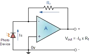

The circuit in your answer relies on the photoelectric effect to amplify the photocurrent produced by the diode with a transimpedance amplifier.
The circuit in your question is relying on the photovoltaic effect but the current direction is wrong (consider a solarcell with a single diode), and it only makes sense with finite gain (ie with an resistor in series with the cathode). There is also an implied photocurrent source in parallel with the diode.
Just how efficient a photodiode would be as a photovoltaic source I don't know but I suspect not very.
EDIT
Photovoltaic amplifier circuit
On second thoughts, R1 is not necessary since even if the diode is shorted, the photocurrent will still flow (again, consider shorting a solar cell).
MikeJ-UK
  • 5,348
  • @stevenvh - Yes, this will be true of any voltage source connected to an inverting amp with no input resistor. – MikeJ-UK Jul 19 '12 at 09:10
    @stevenvh - I just realized that a photo voltaic diode is a really a current source and not a voltage source so my previous comment doesn't apply. – MikeJ-UK Jul 19 '12 at 09:27

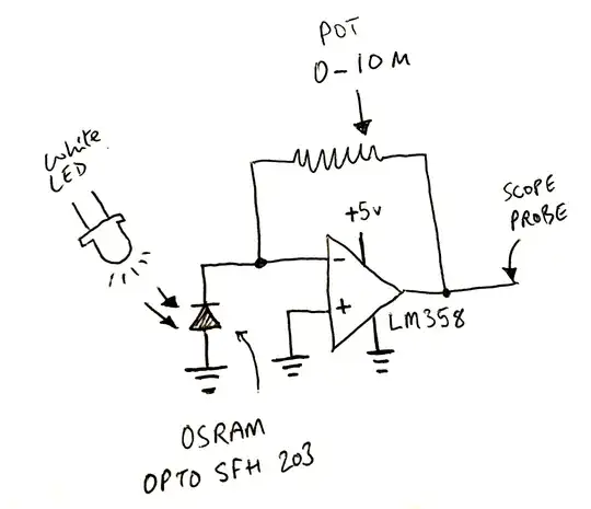

Not sure if this helps but I just tested the circuit below on a breadboard and it works fine. The sensitivity is not great, needs a fair bit of light to register anything and the response is not linear but it definitely measures how much light the white led is shining on it. The resistance affects the sensitivity, more resistance = more sensitive - I tweaked it until it was how I wanted it, somewhere around 100k-300k I think.
The voltage at the output maxes out around 4v but I think that's an LM358 limitation.
