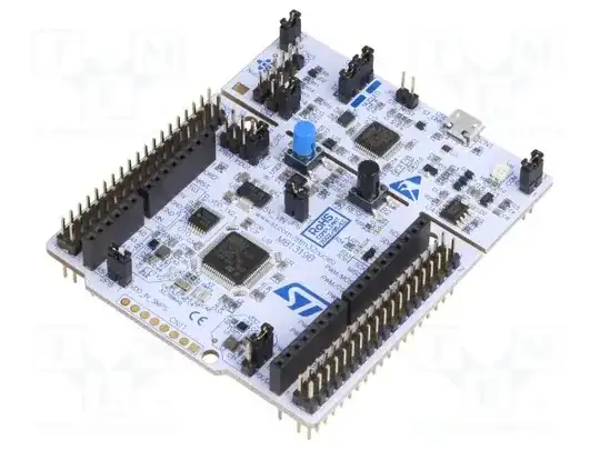

Recently at Embedded World 2018 in Nuremberg I got, for free, NUCLEO-L433RC-P with STM32L433RCT6P chip onboard. I want to broaden my knowledge in STM32 chips. Before, I did simple stuf on STM32F4.
NUCLEO-L433RC-P
All the jumpers on the board are placed correctly.
I opened STMcubeMX, selected the NUCLEO-L433RC-P board from board selection and used all the default settings for it. I also did a version with selecting the STM32L433RCTxP chip directly, not the board, and setting everything manualy. My end goal was to blink a LED.

This is where problems began. After generating code and opening Keil I got the update window and updated everything for STM32L433RCT6P. Under boards there was no NUCLEO-L433RC-P to be found or updated. After closing that window this appeared (I tried and tried again while going through all the options):
options 1
At this point I just tried writing code an seeing what would happen. I have checked everithing in options for targer and compiled everything. After clicking the Download button if got the same thing for both scenarios:
