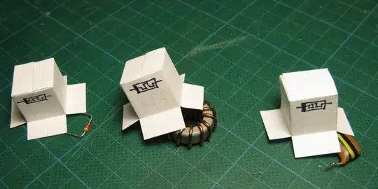

Anyone familiar with Calvin and Hobbes will, I am sure, appreciate this picture. It shows two gyrators in the shape of transmogrifiers; one makes an inductor behave like a capacitor, the other one makes a little 100 nF ceramic capacitor act like an inductor.
Gyrators

Aside from fig. 2 in Chua's paper, here are some other examples that show what practical implementations of mutators might look like:
Mutators
From left to right: A 1N4148 diode (nonlinear resistive element) acts like a memristor (similar to figs. 1b or 2 in the paper), an inductor transmogrified into a memristor (Chua: Fig. 1c), and a 100 nF ceramic capacitor transmogrified into a memristor (Chua: Fig. 1d).
I have to admit that the examples in the pictures are non-perfect: They are white-box models instead of the original black-box models. Other that that, I promise that they actually do work! As a proof, screenshots taken with my Tek 575 curve tracer will follow ;-)
