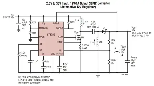

For the following example application circuit that they include,
Example schematic

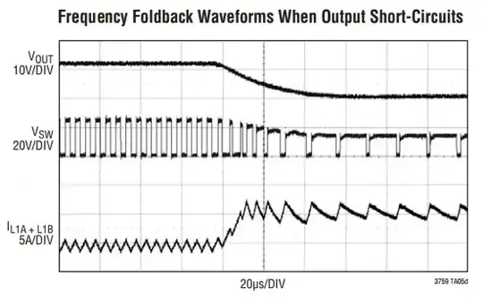

they provide a plot of the frequency foldback waveforms.
Waveforms
This seems different from foldback short circuit protection. But how does frequency foldback work? What would be a good analogy to its process? What would the plot look like without frequency foldback?

Frequency foldback as shown above is simply reducing the switching frequency.
If the switcher is running at the minimum ON time but the inductor current is still rising (the inductor will actually discharge more slowly if there is a heavy load), then the only option left is to reduce the frequency.
You can see on the waveforms when the output voltage drops to 0V, the switching waveform (Vsw) reduces it's frequency. Also note the discharge slope of the inductor is more shallow (bottom waveform)

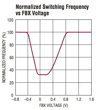

THis is basically a soft start at 40% of the switching rate until it reaches a threshold then it operates at designed speed. If overcurrent drops the voltage it folds back switching freq to 40% until the fault is removed. THis reduces input current at the same time.
It is like an engine turbo that runs at low RPM until the engine reaches 6000 RPM then it speeds up to regulate to the load demand. It changes faster with reverse voltage on the output to slow down the pulse rate.
THis is an over-load soft start and auto recovery design feature.
For loop stability it would be seen as lowering the loop gain, which remains stable.
