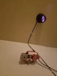

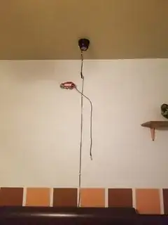

Edit, here's a pic of the setup. This is an older pic of an older IR light that I got from Ebay. Half the LEDs burnt out within about 3 or 4 months. It's since been replaced by another cheap Ebay one, but same basic setup. I'm definitely open to moving things around so it's not so... "in yo face!"
Baby cam enter image description here
