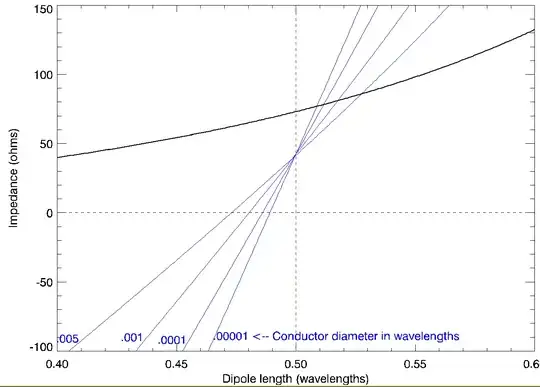

If that ideal antenna were made slightly longer it would change its impedance by introducing inductance. If it were slightly shorter than optimum capacitive reactance would be added to the impedance: -
The black line is resistance and the blue lines are reactance. At the optimum (given that the conductor diameter needs to be taken into account) wavelength (about 0.47) the reactance is zero. Notice that you don't need to make the antenna much longer or shorter to introduce inductance or capacitance.
This gives you the opportunity to tune the phase angle of the received signal from each element to coincide because that reactive impedance is driving into a resistive 75 ohms coax line.
Obviously some antennas produce a different impedance and will need a different feed line impedance.
