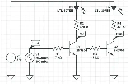

The simplest analog circuit I can come up with is this:
Temperature controlled RGB LED
V1 represents the temperature sensor output value.
The values of R1 and R3 may need to be adjusted specially if you use other transistors (you can use variable resistors to find out the correct values then replace them with fixed value resistors).
You may also need a voltage divider on the base terminal of Q1.
This is the output signal analysis.
This assumes you are using a common anode RGB LED.

  • Bruno, phenomenally nice! Just the kind of basic circuit I was looking for! – Tim Holt Jul 17 '12 at 23:02
  • Can you give a link to the schematic so others can edit it and run the simulation? – compumike Jul 18 '12 at 00:43
  • @compumike Sorry for the late reply. I haven't yet created an account so I could not save the schematic. If you wish, I'll open an account and create it again so I can share it. – Bruno Ferreira Jul 18 '12 at 15:11
