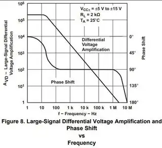

The first thing you may want to look at is the open loop gain of your opamp, you can find it here:
TL081 Open-Loop Gain
That is just the opamp by itself, no interaction with the MOSFET yet. First thing you notice, is that this is very stable as a unity-gain buffer because the phase margin is more than 50 degrees (gain is 1 at about 3MHz, and you measure the difference between -180 degrees and what the phase is at that frequency to find gain margin).

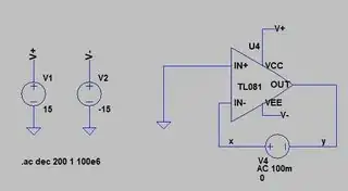

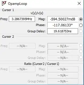

I went ahead an downloaded the TL081 model for LTSpice and here is its loop gain:
The plot matches the datasheet, so far so good (green is the gain, dotted green is the phase). Also, in the cursor window, you can see that the phase when the gain is 1 is -117 degrees, so you still 63 degrees of leeway, that's the phase margin.

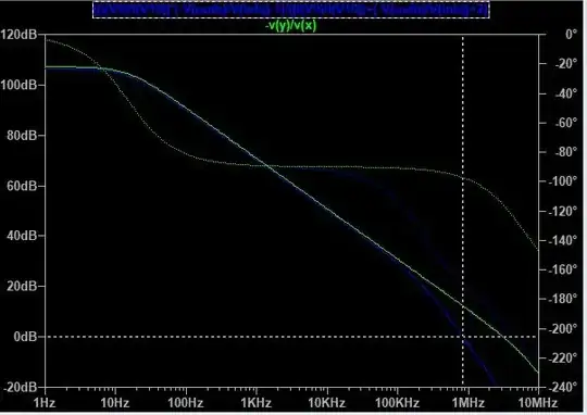

Now, let's include the MOSFET in the model and find the loop gain. You get something like this:
Notice I set the input voltage to 1V, so I am expecting to 1V at \$V_{sense}\$ (labeled as out in schematic) and therefore a current of 1A. If we take a look at how the loop gain and phase margin changes with the MOSFET in there:
The green plot is still the open loop gain of the opamp by itself, the blue one corresponds to the loop gain with the mosfet included. And as you see in the cursor window, the phase margin has worsened a lot, only 10 degrees of phase margin (which means lots of oscillation before reaching stability). Like this...

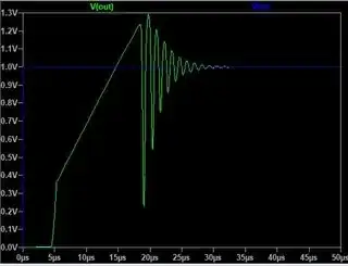

In order to alleviate the issue, you can add some attenuation in the feedback path (this means gain in the closed loop transfer function). By adding some attenuation to the loop gain, the blue plot could be shifted down to a point where you have better phase margin. If you only add resistors in the feedback path, the phase will stay the same (generally, unless they're too big so that you create a pole with the parasitic capacitances of the opamp, different story).
Let's say you now have this circuit, with a gain of 4 (1/4 attenuation factor) for a non-inverting configuration:
Keep in mind now that since we have some gain, the input voltage will be scaled by the gain. Since the gain is 4, we need 0.25V at the input to get 1V at \$V_{sense}\$. The phase margin, with this setup, has improved to about 35 degrees, as you can see in the bode plot (and in the cursor windows):
Still, the phase margin ain't great but it's improving. Obviously, better phase margin at the expense of the bandwidth. You could evaluate other compensation techniques or maybe something like this is good enough for the application.
