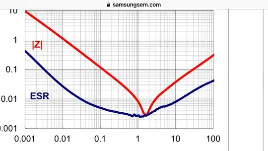

This is correct only as a line f* diode bridge cap. Tan delta is std at 120Hz.
It is unwise to use as that*.
Unlike some or most e-caps this ceramic cap drops to 3 mohms near SRF ,~1MHz
Look for the PDF with my graph (re-search) hint Samsung site
Answer: char. Data.pdf http://www.samsungsem.com/global/support/product-search/mlcc/1205485_4290.jsp
  • I thought char data was "char" like text. Kind of stupid of me, but on the other hand, Samsung could make this a bit easier to find! Thanks, Tony! – user57037 Feb 26 '18 at 19:38
    char(dot) is rather brief isn't it. I wonder what the other files say? More treasure ... flash search engine. The Japanese know these parts and tricks but release to the ROTW years later. et tu Korea – Tony Stewart EE75 Feb 26 '18 at 21:03
  • Samsung has moved things around. That link doesn't work any more. The data can be found here now: http://weblib.samsungsem.com/mlcc/mlcc-ec-data-sheet.do?partNumber=CL21A226MQQNNW – user57037 Jun 16 '21 at 06:26

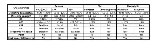

DF can vary a lot between dielectric types. See this: -
It lists the poorer stability ceramic diectric DF as being 5% (Y5V) whereas the DF for NP0 is about 0.1%. Electrolytic DFs can be as high as 20%. Table acquired from here.
