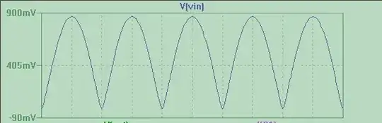

Is the formula X\$_L\$ = 2\$\pi\$fL still true for rectified (but unfiltered) AC (in which case the frequency f, and therefore the reactance, would be doubled in the case of full-wave rectification)?
I forgot to add a parasitic resistor in series with the inductor. The inductor is not ideal as depicted in the image above.

We can see that by solving the differential equations governing the circuit or... by simply using a simulator :-) I ran a couple of LTSpice simulations feeding an inductor with a full-wave rectified sinusoidal voltage and current generators controlled by this voltage:
I had to use voltage controlled voltage and current generators to make sure the L circuit did not load the rectifier (which it does, and a lot). The results are strikingly different.
When a voltage V(out2) with that shape is forced across an inductor, we get a current that builds up indefinitely, as shown by the purple waveform I(L2). This is not surprising, since to get the current we need to integrate the voltage over time and since V(out2) never go negative, we can only add, and add, and add...
But if a current I(L1) with that shape is forced into an inductor, we get a periodic distorted triangular-like voltage V(out) across it. The reason for this strikingly different behavior is that now to get the shape of the voltage we have to take the derivative of the current.
It worth noting that the concept of impedance requires that the signals be both sinusoidal and steady state. The above example has used a piecewise sinusoidal stimulus and although in each period the derivative and integral are still sinusoidal in shape, the overall waveform shape is not. When the derivative is involved we have discontinuities (in the above simulation they are softened because the input signal was, since I have used real diodes in my full-wave rectifier); when the integral is involved, we have a build up due to the value of the integration constant set by the boundary conditions.
In either case, since derivatives and integrals of functions that are not exponentials, sines or cosines return in general functions with a different shape, you can no longer describe the effect the inductor has on the stimulus waveform as a simple attenuation and phase shift. The bottom line is that you can kiss the concept of impedance goodbye.
