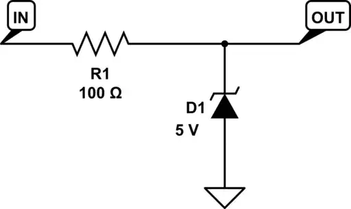

Probably the simplest is a simple zener limiter:
This will also limit negative voltages to about -0.7 V, though this limit will not be well controlled.
Edit: I show 100 Ohms at R1. This is just a default value. You want as high a value as you can use, given the bandwidth of the signal you're sampling and the input current needs of your ADC. The higher this resistance, the lower the current the zener needs to sink in an over-voltage condition, so the smaller (and lower-cost) the zener can be. You may want to add a capacitor in parallel with the zener so that it combines with R1 to form an anti-aliasing filter for your ADC.

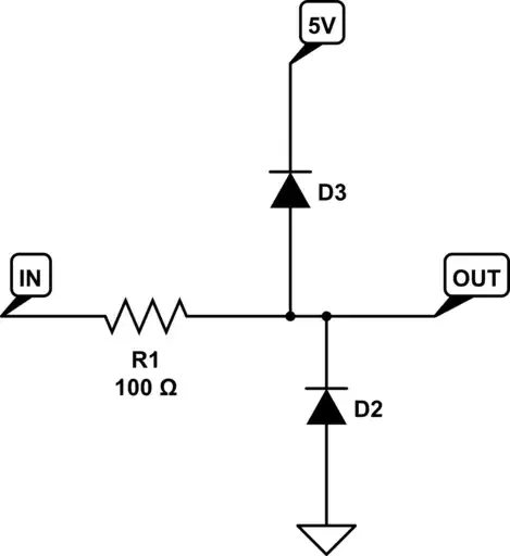

A lower cost option if you have a 5 V rail that can sink enough current, and you don't mind the limit value being slightly above 5 V:
You can buy the two diodes in a dual package for exactly this purpose. If you want the limit value to be nearer 5.2 V than 5.7 V, use schottky diodes instead of regular silicon diodes.

As Steven points out, there's a trade-off here. A zener will start to conduct slightly at low current levels, and the source you're measuring needs to be able to provide enough current to drive it all the way to 5 V to get the clipping you want. If you absolutely need to be able to get to 5.0 V before clipping begins, you may need to use, say, a 5.3 V zener instead of 5.0 V, and be sure your source can provide at least 10 uA. Then of course you aren't guaranteed to clip below 5.5 V.
On the other hand, the diode connection to the positive rail (my second solution, whether using external diodes or the ones that are probably built in to your ADC inptus) will only work if there are enough loads on the 5 V rail to sink the current provided by the overvoltage source. In a low-power circuit, the overvoltage could end up driving your 5 V supply out of regulation and cause all kinds of unexpected behavior in other parts of your circuit.
You can limit the current that needs to be sunk in the overvoltage condition by increasing the R1 value. But your ability to do that is limited by the bandwidth you want to be able to measure in your input signal and/or the input current needed by your ADC.

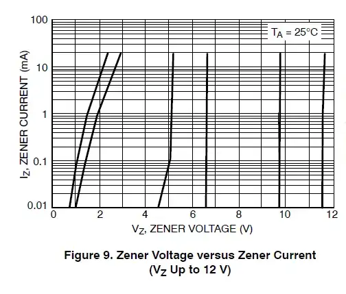

It's also not true that the zener voltage "varies wildly with current". It would be more correct to say there is a small leakage current, on the order of 10-100 uA, below the zener threshold. Once the zener enters avalanche operation, the voltage can be very stable across decades of current. Here's the typical I-V of an On Semi zener family:
Note that higher-value zeners have better stability than low-value ones. And of course there are also thermal variations (1-2 mV/K typical for the On Semi part at 5.1 V) to worry about if you want a very stable clipping voltage.

  • thanks, I'll try it. is there a reason behind the resistor value? The zener diode is hooked up to 5V right? Will any old diode work for the second option? What happens if I cannot sink enough current for the 5V supply? Also what software did you use to make the diagrams? They look great. – waspinator Jul 16 '12 at 03:26
  • The resistor value will depend on the input impedance (or current input needs) of your adc, the sampling rate, and the required bandwidth of the input signal you're measuring. 100 was just the default value in the circuitlab editor. – The Photon Jul 16 '12 at 04:44
  • Also, the zener is not hooked up to 5 V. It's hooked up the way it's shown in the schematic (cathode to the signal line, anode to ground). – The Photon Jul 16 '12 at 04:45

  • For the second circuit, the diode must be able to handle 5 V reverse bias (should be okay with *almost* any diode) and must be able to handle however much current might be present in an overvoltage condition (depends on R1 and what kind of overvoltage you're expecting). – The Photon Jul 16 '12 at 04:55
  • Note that a zener's voltage varies *wildly* with current, see the example in my answer. – stevenvh Jul 16 '12 at 12:55
  • ok so I should use regular/schottky diodes for better operation. What should I use for the 5V supply? would a microcontrollers 5V output or a USB port be safe? – waspinator Jul 16 '12 at 14:15
  • That OnSemi devices indeed don't look bad. Do you have a part number? I'd like to see their differential resistances. – stevenvh Jul 16 '12 at 17:09
  • MMSZ52xxxT1G. I just picked it randomly as their lowest-power (500 mW) zener family. 17 Ohms for the 5.1 V device at 20 mA. – The Photon Jul 16 '12 at 17:20
    @waspinator, You use the same supply that's supplying your ADC. The current coming from the overvoltage condition needs to be sunk through the supply pins of the ADC and other parts in your circuit. – The Photon Jul 16 '12 at 17:26
  • "You can buy the two diodes in a dual package for exactly this purpose" Interesting. What's the package called? – m.Alin Jul 16 '12 at 17:28
  • @m.Alin, typically SC-70 or SOT-23. See On Semi BAT54SW, for example. – The Photon Jul 16 '12 at 17:36
  • @ThePhoton - like you say the 17 ohms is at 20 mA. Not a bad figure, even when they always get better the closer you are to about 6.5 V. But at 0.25 mA it's 1600 ohm, and depending on the source impedance (I'm thinking of a resistor divider) you'll be much closer to that. At 5 uA this 5.1 V zener becomes a 2 V zener! That's what I meant by "wildly varying". *All* zeners have this for very low currents. – stevenvh Jul 17 '12 at 17:46
  • @stevenvh, You can call it "wildly varying", I can call it "leakage current". Driving an ADC, there are other good reasons to have low source impedance besides just needing to provide for leakage current here. One solution has essentially no leakage current below the clipping point but requires high source impedance to avoid uncontrolled circuit operation; the other solution is independent of other supply loads but requires a low source impedance. Classic engineering trade-off. – The Photon Jul 17 '12 at 18:35
