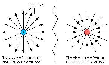

The directions can be visualized as:
Electric Field Directions
These directions and magnitudes are determined based on the force (direction and magnitude) that would be exerted upon a positive test charge. In other words, the field lines represent the direction and magnitude a test positive charge would experience.
A negative charge would experience a force of the same magnitude in the opposing direction.
By this convention, when an electron is near an electron or a proton near a proton, they will repulse.

Electrons want to move from a place of high voltage to a place of low voltage as quickly as possible, such as from one end of the battery to another. If the two ends of the battery are connected directly together by wire, the electrons will all jump incredibly quickly to the low voltage end, because there is nothing slowing them down.
The resistor slows down how fast the electrons can move through the circuit. Without the resistor, the battery will instantly burn out.
    (1) "*... the electrons will all jump incredibly quickly ...*". No, the speed of the electrons is measured in mm/hour. See [Electric drift](https://en.wikipedia.org/wiki/Speed_of_electricity#Electric_drift). You are confusing it with the speed of the electric wave. (2) "*Without the resistor, the battery will instantly burn out.*" No, the battery's internal resistance will limit the current. Try it yourself: put a short circuit on a AA for a few seconds. According to your answer the battery will "burn out". It will neither burn nor go instantly flat. – Transistor Feb 22 '18 at 21:26
    (3) "*Electrons want to move from a place of high voltage to a place of low voltage ...*" The opposite is true. Electrons will move to the higher potential. – Transistor Feb 22 '18 at 21:26
  • It's just a laymans explanation, intended more to help form an intuition than be technically thorough. – DoctorMoose Feb 22 '18 at 22:02
    It doesn't have to be technically thorough but it should be technically correct otherwise the OP will be as confused as you are. – Transistor Feb 22 '18 at 22:05
