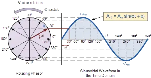

One full cycle of a sine wave "maps" to a circle turning through 360 degrees: -
https://www.electronics-tutorials.ws/accircuits/phasors.html
Source: https://www.electronics-tutorials.ws/accircuits/phasors.html
So, at an angle of 30 degrees, if you calculate sin(30) on your computer or calculator you get 0.5 i.e. the sine amplitude is 0.5. At 60 degrees it's 0.866 (or \$\sqrt{0.75}\$ if you did the math/trigonometry).
At 90 degrees it's 1.
If your computer or calculator uses radians (rather than degrees) then 360 degrees is \$2\pi\$ radians.
