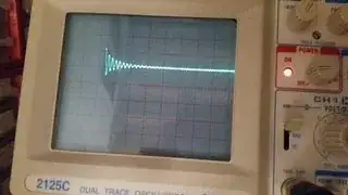

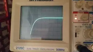

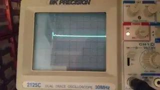

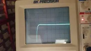

Well, I did some measurements with my scope and function generator. And yes, I did see overshoot/undershoot, ringing, settling time and rise time within output (square) signal, when I was varying the closed-loop gain of amplifier in wide range of values. But there was something strange about it. When the closed-loop gain was high (around 500), I could saw slower rise time of output signal and when closed-loop gain was low (approx. 11), I clearly saw the presence of overshoot/undershoot and ringing within output signal - did I messed up things when I was learning about step response of amplifier or are things that concern overshoot, etc. showing up in reversed order?
Overshoot and ringing Less overshoot and ringing Something in the middle Slower rise time

  1. The first picture on the higher left corner is the step response of you differential amplifier with minimum \$P_{F1}\$: it is the classical response of a second order underdamped system, with heavy ringing and over/undershoot.
  2. You increase \$P_{F1}\$ and the behavior is still the same but both ringing and over/undershoot start to vanish, as shown in the picture on the higher right corner.
  3. Continuing the rise of \$P_{F1}\$ you reach the critical value of damping: the rise time of the system is optimal, without ringing and over/undershoot, as shown in the lower left corner picture.
  4. Finally, the gain rise make the circuit response indistinguishable from the one of a first order system, as shown in the lower right corner picture.
