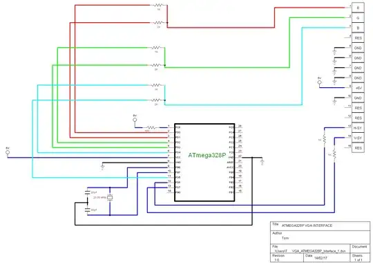

An image of the schematic for the hardware implementation can be found below the code.

ATmega328P hardware implementation
Results
Having tested the hardware and software implementation, I've found it works well on the VGA interface on my living room TV, but does not work on any other monitor or TV I've tested. I've found it sort of works on a friends monitor, it will output a red screen but with random black patches and will periodically lose signal. The other monitors I've tested on do detect the input, but are just unable to output anything on screen.
I believe the reason it works on some displays and not others, is simply down to the tolerances the manufacturers have stipulated in their devices.

    Do you have an oscilloscope? – filo Feb 19 '18 at 21:12
  • I've tested using a logic analyser, however I do intend testing with an oscilloscope. – Tom Finch Feb 19 '18 at 21:14
    I remember that the receiver part of the monitor logic checks if the timing signals are within the acceptable deviations. Can you verify that your signals fit the monitor specs? – Nazar Feb 19 '18 at 21:23
  • Having looked at the spec sheets for the monitors, I can't find specific details as to the timings accepted by the monitor. They simply say 640*480 @ 60 Hz (59.94 Hz). – Tom Finch Feb 19 '18 at 21:26

    Consider that VGA inputs often have an impedance in the range of 75 ohms. If these are resistively terminated, your 1K and 2K series resistors will yield very low levels. – Chris Stratton Feb 19 '18 at 21:58
  • The voltages are okay from my calculations, taking into account the 75 ohm resistor, the lowest voltage will be approximately 0.3V which is well within the voltage range of 0 and 0.7V and like I say the output is fine on one of the monitors I tested on. – Tom Finch Feb 19 '18 at 22:03
  • The point is that monitors vary in what level they will accept. Your sync signals in particular are likely not going to swing enough. – Chris Stratton Feb 27 '18 at 17:44

The 3 color lines expect 0 to 0.7V. And I see you've sized your resistors such that, with a 75Ω impedance, it will result in either 0.696V or .348V.
I know that probably seems like a very nice, elegant solution to get black + two shade, but I am afraid it won't work very well. Your resistors are much too large and this is causing a bad case of impedance mismatching. And you would likely experience the exact problems you describe - some displays (a small minority I would expect with resistors that large) would be able to use the signal, but most would not, or only correctly read pixels intermittently per each frame.
If you want to properly drive a 75Ω impedance while reducing a higher voltage to the correct voltage range, you need to use an impedance matching network, like an L-pad divider.
Discussing the theory behind L-pad dividers is kind of beyond the scope of this question, but you would do well to use transistors to properly set the voltage levels without having the high impedance of a divider.
Here, just to do a sanity check and see if my guess is correct, ditch the second IO line on the 3 color inputs. You can't correctly drive a VGA input using the 75 ohms as a participant in a voltage divider anyway, so you'll have to ditch that idea entirely I'm afraid. You can get away with using a proper DAC style ladder, but even then, all the resistors will be an order of magnitude smaller than 1K and 2K.
Just use one IO pin, and I just realized this probably exceeds the single pin current... 50mA I think? But the ideal l-pad for 75Ω that attenuates 5V to 0.7V would be a 64Ω and 12Ω resistor in series to ground, with the signal out to the display being the tap between the two.
The magic here is that, if you remove my rounding errors, this results in a resistance of 75Ω. That is what matched impedance means. That each end has the equivalent to 75Ω from the signal pin to ground.
Basically, the pins of your atmega aren't strong enough to drive a 75Ω impedance at full power when running from 5V, as that would consume more than 50mA. Instead, just use a ladder with a similar ratio, but not so large. Try 220Ω and 56Ω, and that should resolve your signal problems and reduce the signal voltage to 0.7V WITHOUT having so much of an unmatched impedance that most displays won't even work correctly.

    Not really. Signal reflections from impedance mismatch are not the problem. Inadequate levels might be, but reflections on the color lines would just cause ghosting, which isn't what is being observed. Look at circuits actually used for this, and you'll see that the issue here isn't the lack of a pad attenuator, but simply having too high a series source resistance. Most likely the actual problem is with the sync signals, not the colors. – Chris Stratton Feb 27 '18 at 17:46
    Hi, yes you're right Chris. It was due to the sync signals. Impedance's were fine no issues with the resistor sizes. It came down to the fact that, every new scan line requires a horizontal sync pulse, even during the porch regions. Maybe its just me, but from the documentation I'd read, this wasn't clear from the VGA specification. Having made this change it works perfectly on all monitors I've tested on. It just happened that one TV I tested on didn't seem to mind if the H-Sync wasn't on every line! – Tom Finch Apr 12 '18 at 21:26
