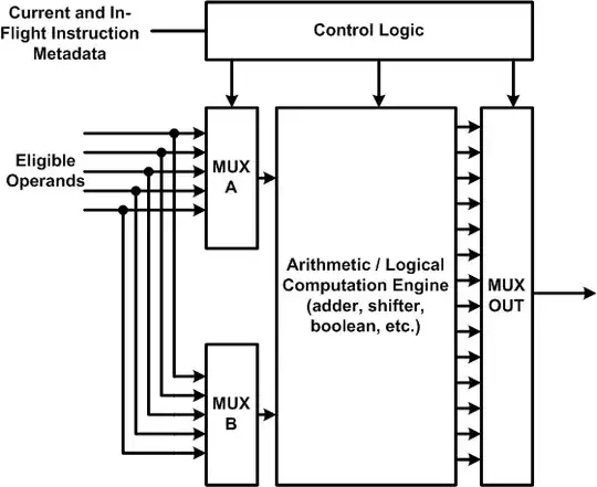

As others have noted, an ALU's function is to perform (typically either binary or unary) arithmetic and logical operations on input busses. You can break an ALU down into three primary stages along with some control logic that configures those stages.
  • Argument Selection: this stage really really is just a Multiplexer for each input that allows for the selection of various inputs for either argument (i.e. RegisterA, RegisterB, MemoryLoad, Pipeline Byassed Value, etc).
  • Arithmetic/Logic Computation: this is where all the math gets done in parallel on the selected / routed inputs
  • Output selection: this can be thought of as a logically as another multiplexer, but for reasons of fan-in/fan-out is often implemented as a tri-state bus with the various output enables driven by a decoder based on the instruction op-code.
Here's a really high level drawing I whipped up to illustrate this partitioning.
There may be debate about whether the first stage and control logic is really part of the ALU, or if it is rather simply part of the Execution stage of the CPU Pipeline.

  • +1 for clearly pointing out that a mux is usually a very small piece of a much larger ALU. I wish I could give you another +1 for pointing out that an ALU is performing *all* math operations in parallel, and the mux selects the operation that was requested by the instruction. – ajs410 Jul 13 '12 at 22:24
