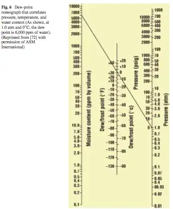

enter image description here As stated in above link
  1. "the internal outgassing may induce the formation of water droplet condensation, thus compromising the device performance and even- tually leading to device failure." 2." seals produced were hermetic initially, but tended to fail catas- trophically during prolonged soaking and temperature cycling in saline because of the difference in the CTE between the glass capsule wall (5.5 × 10−6/◦C) and the 90% Pt–10% Ir feedthrough (8.7 × 10–6/◦C). "
  2. " From the nomograph in Fig. 6, it can be seen that at 1.0 atm and 0◦C, the moisture concentration needed for forming water droplets is 6,000 ppm. At levels below this percentage of water vapor, liquid drops will not be able to form. Hence, most materials and sealing processes are selected to keep the internal package environment at or below 5,000 ppm of moisture for the lifetime of the device." However contamination can alter this. enter image description here
