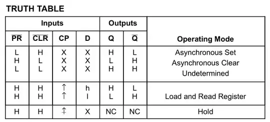

How does this circuit exactly work? The truth table of a flip flop with asynchronous reset is (here given for the NL17SZ74):
D-type flip flop truth table with asynchronous preset and clear
Specifically, the clear (or preset) inputs are asynchronous and hence affect output immediately, independently of the state. Only when \$\overline{PR}\$ and \$\overline{CLR}\$ are both high, the flip flop responds to the edge of the clock and works as a flip flop.

We call a clocked event synchronous and Preset ( or set) or Clear (or Reset) as asynchronous events.
Your cct gives an asynchronous Preset and only when released ( going high) allows CP to transfer D to Q and thus reset the "1" to a "0" giving a +ve pulse with only synchronous trailing edge.
So it only cleans up the negative edge in your case. The prefered way is to use D input and then both edges are synchronous. But this relies on your input D being longer in any state than the period between clock pulses.
i.e. a much slower square wave clock.
Also PR and CLR are both "negative logic" meaning active low. Some CMOS FF chips are "positive logic" for Set and Reset for various reasons not relevant now.
