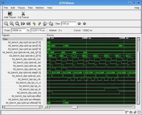

You could also try simulating in GTKWave (or any other circuit simulator with a logic analyzer): Example GTK Wave Screenshot
(source: bec-systems.com)
but that's oriented more towards simulation of Verilog/VHDL/schematics, rather than just drawing waveforms.
