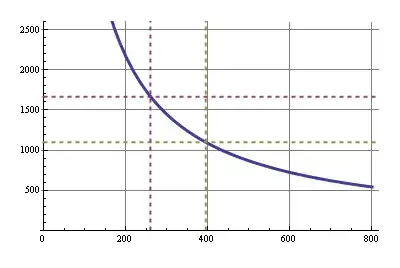

The graph shows maximum pull-up resistance (in Ω) versus cable capacitance (in pF) to get 1000 ns rising edges. Note that I2C devices don't have to sink more than 3 mA, therefore at 3.3 V the bus capacitance shouldn't be higher than about 395 pF, otherwise the pull-up resistance would have to be smaller than 1100 Ω, and allow more than the 3 mA. That's the greenish dashed lines. For 5 V operation the allowed capacity is even 260 pF, for a 1667 Ω pull-up value (the purple dashed lines).
