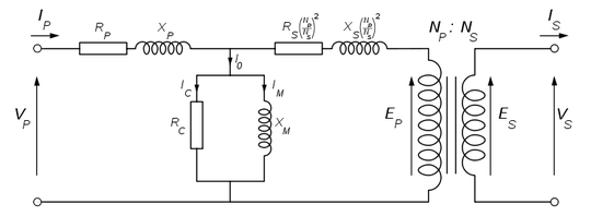

In the opposite case where we step up voltage I can understand what's going on by looking at the transformer model:
If the secondary coil number gets higher, the current to the R_s branch gets higher. So even though the current is stepped down, the power used becomes higher as we are "pulling" more current from the supply.
But what happens when the current is stepped up? If the primary has more turns, it would seem that the ratio N_p / N_s is higher and the current to the R_s branch is lower.
Could somebody explain to me what is it that I'm misunderstanding? Why is it better to step up the amperage, rather than just use the input AC voltage or step up the voltage instead of the current?

The issue here is that, in practice, there is a limit to the current that the supply can deliver. It is also important to distinguish between what are causes and what are effects, or, in other words, to identify the dependent and independent variables - for one thing, this should clear up the issue raised in your addendum.
Assuming a fixed workpiece resistance, an ideal fixed-voltage power supply (up to its maximum current), and a perfectly-efficient transformer etc., the dependencies are thus: The supply voltage \$Vp\$ and transformer turns ratio \$N1/N2\$ determine the secondary voltage \$Vs=Vp.N2/N1\$, which, together with the workpiece resistance \$Rs\$, determines the secondary current \$Is=Vs/Rs\$, which in turn, together with the transformer ratio, determines the primary current \$Ip=Is.N2/N1\$. The maximum current that can be drawn from the supply (or the maximum current the transformer primary can take, whichever is smaller) is another independent variable.
Consider your statement “If the secondary coil number gets higher, the current to the R_s branch gets higher. So even though the current is stepped down, the power used becomes higher as we are ‘pulling’ more current from the supply.”
Excluding the clause 'even though the current is stepped down', which is probably not the case, then the rest of this statement is correct, as far as it goes: increasing \$N2\$ increases the voltage across the load, and therefore also both the current through it and the power dissipated in it. For example, if \$N2\$ is doubled, \$Vs\$ is doubled, leading to \$Is\$ also being doubled, so the power dissipation is quadrupled. The consequence is that the primary current draw is quadrupled, as can be seen either from the conservation of energy applied to the primary and secondary circuits, or from the transformer relation \$Ip=Is.N2/N1\$, where both \$Is\$ and \$N2\$ have doubled. When adding more secondary turns, however, it is not long before the primary current reaches its limit.
So, you are correct to say that increasing the secondary turns will increase the power delivered to the workpiece, but only up to the point where you begin to overload the source. In practice, if you apply your source voltage of 240V directly to the workpiece, you will almost certainly overload the supply, in which case you will need a step-down transformer simply to stay within that limit. To deliver the most welding power, you need a transformer that does the least voltage stepping-down while also keeping the primary current within its limit.
Note that to understand this issue well enough, you do not have to consider the parasitic impedances shown in the diagram, which are comparatively small and merely complicate the matter without adding any insight. On the other hand, as others have mentioned, there will also be dissipation in the secondary windings, so you need to use wire of sufficient diameter to handle the secondary current - at least sufficient to avoid overheating, and beyond that, the lower the resistance of the secondary, the less power will be dissipated there rather than in the workpiece. If the maximum current for the primary circuit is \$Iplimit\$, the corresponding secondary current is \$Iplmit.N1/N2\$. If, as in the video, you are modifying an existing transformer, the maximum power of your welder may be set by the the physical limit on the number of turns of large-enough wire that you can fit on the transformer armature.
