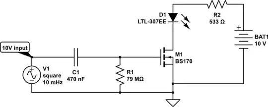

On the one hand, you want a resistor of 533 ohms.
On the other hand, you want a resistor of 79000000 ohms.
That's quite a span to overcome.
It seems that a small MOSfet transistor would be useful to span that difference. Its high-resistance gate has resistance larger than 79 Megohms to ground. And its low-resistance drain-to-source path is much lower than 533 ohms. So a circuit like this is possible:
simulate this circuit – Schematic created using CircuitLab When C1's input side rises to +10V, the MOSfet turns on, and 15 mA flows through R2 and the LED.
C1 will initially raise M1's gate voltage to +10V, but then start discharging through that very large R1, toward zero volt. After a time, M1's gate voltage will have dropped to about +2V, and M1 will start to turn off.
This is a conceptual circuit to show how the RC time constant of C1 x R1 could be used to stretch the ON period of a relatively high-current LED. In practice, that 79M resistor on the gate may be too large - the leakage current of that BS170 MOSfet may interfere.
