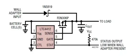

One option I'm considering is the LTC4412 power controller, recommended in answer to someone else's question.
Question 1: Does this look suitable?
One concern I have is the delay in switching over from USB bus power to battery power when the device is disconnected from USB. According to the LTC4412 datasheet, the turn-on time for the MOSFET gate can be up to 175 us. I don't want the CC1111 (or the digital sensors) to reset. Looking at Figure 1 in the datasheet (see too the discussion of bypass capacitors on page 5), the trick is to properly choose a value for the output capacitor, C_out. I calculated a value, but I'm not sure if my approach is valid. If you'll bear with me:
Figure 1
The CC1111 is normally operating at 3V from 2 AA batteries. Suppose it could operate at only 90% of that (2.7 V). I use the current drawn by the load (my device) and the nominal voltage (3V) to come up with an equivalent resistance (V/I). Based on my measurements and summing currents taken from datasheets, the device can draw a current somewhere between 35 mA and 70 mA. This gives me an equivalent resistance in the range of 43 Ohms to 86 Ohms.
If I want the voltage to drop to no less than 90% after 175 us (the LTC4412 gate turn-on time), then after doing the math I get a time constant (RC) of 1.66 ms. Using 40 Ohms to be safe, I come up with C > (1.66ms/40 Ohms) = 42 uF. Maybe add another 10% or 20% for safety, so say 50 uF.

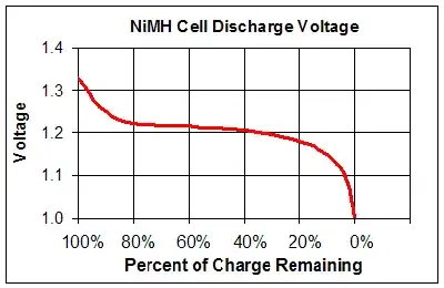

No, like you already may have feared this isn't kosher. The 3 V is indeed the minimum, and the AA batteries' voltage will quickly drop below that. If you're using NiMH rechargeables you even get only 2.4 V, so that won't do, unless you can use 3 of them in series. (Don't use batteries in parallel like you mention in your question.) So three NiMH cells will give you 3.6 V. Fine.

Now the switching. 175 µs seems like an eternity to me, but we'll have to live with that. Ben gave you already the right equation for a constant current discharge:
\$ \Delta V = \dfrac{I \cdot \Delta t}{C} \$
or
\$ C = \dfrac{I \cdot \Delta t}{\Delta V} \$
NiMH cells have a fairly constant 1.2 V, which only drop to below 1.1 V when they're nearly discharged.
So we can use that as a limit. With a minimum voltage of 3 V and a worst-case current of 70 mA you get
\$ C = \dfrac{70 mA \cdot 175 \mu s}{300 mV} = 41 \mu F \$
which is what Ben also found. If you think you won't go below 1.15 V then that would become 27 µF, so that's not going to change very much, but it gives you some headroom if you want to use a 47 µF cap. AndrejaKo rightly points out that electrolytic capacitors have large tolerances, usually -20 %, and then I would just go for a 68 µF/6.3 V cap.

No, you shouldn't use a resistive time constant equation for active electronics. Just assume a voltage-independent current draw, along with the capacitor equation:
I = C * dV/dt
and solve for C.
C = I * delta-t / delta-V
  = 70mA * 175uS / .3V = 41 uF
(ok, that's pretty much the same, because R-C discharge current is above 90% of the starting value while the voltage is above 90%)
The USB specification states that the maximum capacitive load that can be placed at the downstream end of a cable is 10 uF. You're going to have a problem if your batteries were discharged, unless you current-limit the USB source.
