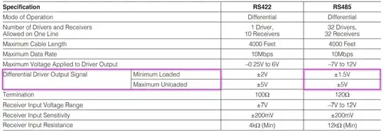

I suspect the answer is in bold in the first line of your question. The resistor is between the data lines but the differential voltage is only a few volts - the common mode voltage can be anything but won't cause an increase in potential across the termination resistors.
Figure 1. Extract from Linear's TIA/EIA-485-A Standard.
The table above says that the limit is ±5 V. Rerunning your calculation gives \$ P = \frac {V^2}{R} = \frac {5^2}{120} = 0.208\ \mathrm W \$ max.
The 0.25 W resistor should be fine.

  • thank u that makes sense now , it seems i goofed up the definition about the common mode voltage . which is the voltage from one of the lines ( A or B ) with respect to GND. – ElectronS Feb 10 '18 at 20:34
  • actually looking at TI's SLLA070D, section 2.1.1, RS-422 allows up to 10V transmitter output differential voltage. On the other hand, the receiver should operate on a max differential input voltage of 12V (table 1 - note 1). I also checked an online scanned copy of the TIA/EIA-422-B standard (MAY 1994) and it confirms TI's statements. Linear Tech. on the other hand didn't even bother to reference the table you mentioned. – fhlb Feb 12 '18 at 15:39
  • Ah, but the question is about RS485! (I don't know much more about it.) – Transistor Feb 12 '18 at 17:40
@Transistor's table says +/-1.5V min loaded and +/-5V max unloaded so with 120 Ohms the actual power will be slightly less depending on driver ESR which tends to be around 25 Ohms for 3.3V technology and a bit more up to ~50 ohms for 5V technology , so the \$V_{OD} \$ differential will be less than 5V or 0.2W, which "may" still ok.
