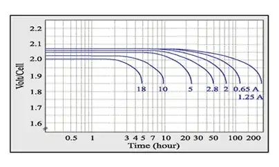

In practice, no. The Ah rating will decrease when the discharge rate is increased. The battery datasheet should quote that.
Figure 1. A lead-acid battery discharge for various discharge rates. Source: Samlex Solar.

They are of use but they are only one of the specifications you need to assess when designing a system. The discharge rates (Figure 1) are another, maximum charge rate, etc., all have to be considered.
