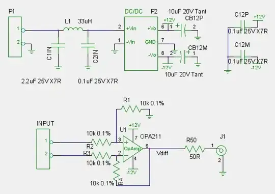

Schematic:

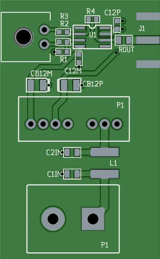

PCB:

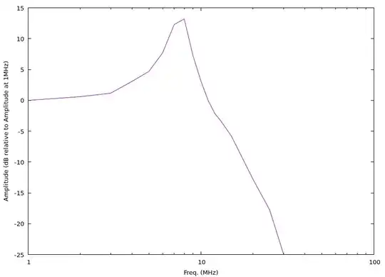

And this is the frequency response that I get:
The ground plane is at the bottom layer, and the top layer has a copper fill that is connected to GND at the pins of the BNC edge connector (J1). This BNC connector (J1) is 50Ω; I connect it to a 50Ω BNC cable that goes to a 50Ω-terminated input capture device (a 180MSPS 16-bit Digitizer card on a PC --- the card itself specifies a 65MHz input bandwidth).
On the input side, however, there is no impedance matching --- to measure the frequency response, I use a signal generator with 50Ω BNC output, but I connected a cable that goes from BNC/coaxial to clips, and as you can see, the input goes to my board through a header type connector (more like a Molex-type, with locking housing).
BTW, when measuring the frequency response, I used a sine waveform with 100mV pk-to-pk to avoid issues with the slew rate (27 V/us as per the datasheet).
The ringing should not be surprising: it could be attributed to the op-amp getting closer and closer to instability when pushed to a low gain. But the low bandwidth is quite surprising --- precisely, at the lower gains I should expect higher bandwidth, right?
I also expect that parasitic capacitance or inductance (board, traces, ground plane, etc.) should not be an issue at such low frequencies (I would expect those to kick in at the hundreds of MHz range). For that matter, impedance matching (or lack of impedance control when ordering the PCB) should not play any role on the ringing at such low frequency, right?
Any ideas why such low bandwidth and why the peak at 8MHz?

Your resistors are too high value. Differential input capacitance of that op-amp is 8pF, which gives you a pole at 2MHz.
Parasitics from the ground plane are not helping either.
Try 1K resistors.

The resistors and the tracks form to make weak capacitors. Rf=500~750 is close to optimal for this part.
Layout is crucial in these designs. The ground plane should be removed from the area near the input pins to reduce stray capacitance. The Zo also rises to 50 Ohms @10MHz from lack of negative feedback gain which forms another LPF with 10k. @2MHz
Taking a closer look at the datasheet, Fig 24 shows the optimal response peaking with about 5% overshoot as they show is with 6.8pF of added neg. feedback and 680 Ohms for R instead of 10k. The 10pF load is intended to simulate a 10:1 probe may also affect this value.

Your not reading the fine details in the data sheet. The differential impedance is 20 K/8 pF. Figure 24 shows an inverter with a gain of -1 using 604 ohm resisters and a 5.6 pF feedback capacitor.
It is implied that a feedback capacitor is mandatory for stability, to overcome any parasitic positive feedback.
This ties in with Spehro Pefhany's answer, and that is to keep resistors at 1 K or lower, especially on the inputs. This is an RF amplifier, so treat it like one. That is has great audio parameters is just a sign of how much technology has advanced, but do not wire it up as an audio op-amp with 10 K resistor inputs, etc.
One drawing shows a gain of 10 with 1 K inputs and 10 K feedback. As a differential op-amp it would seem that 500 ohm inputs with a 10 K to ground and a 10 K feedback with a 4 to 6 pF feedback capacitor would max it out for a gain of 20 (26 dB) at a wide bandwidth.
