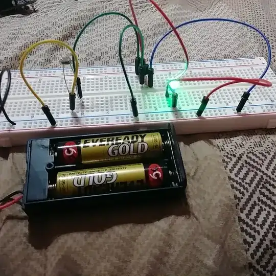

I am fairly new to electronics and circuitry, and I ran into a small problem while trying to make a simple circuit on my breadboard. The objective is for the LED to turn off when the photoresitor receives light and turn on when there is no light. The circuit worked fine with the arduino power supply module until I tried to connect it directly to a 3V battery pack. I tried 6V and it did not work either. The problem is that the LED does not seem to be affected by the photo resistor when a battery is connected (always being on). Here is a picture of the circuit when the light is on with the power module:
Here is a picture of the circuit when the light is on with the batteries:
Thank you for your time.

  • i see what happened. ... you have the LED directly across the battery. ... the transistor is also across the battery ... the transistor is not controlling the LED ... the 9V battery is very weak ... it lights up the LED ... when the transistor shorts out the battery, the LED goes out ... the AA batteries are able to deliver much more current, so the transistor is probably blown – jsotola Feb 06 '18 at 05:48
  • When drawing schematics, please try to put the positive supply at the top of the drawing, and Ground at the bottom, and signals flowing from left to right - makes it much easier to understand, and to see mistakes. You still have the LED and resistor directly across the supply. As @jsotola says, you also have the transistor across the supply in parallel with the LED. You probably want the LED and resistor between the transistor's collector and the positive supply, so the transistor can control the LED current, rather than shorting the supply. – Peter Bennett Feb 06 '18 at 06:03

Otherwise this is what I see in your 1st photo. (minus R1)
If your had 4.5V then you would be adding 1.2V /12mA = 100 ohm in series.. If you had 6 V then you would be adding more resistance to limit LED current... Right now the LED voltage almost matches the 3V battery but not quite., 6V would burn it out the transistor.( as in hot)
With 3V vs 3.3V it makes a huge difference in LED current as this is right at the LED voltage threshold. ( so 3V is not quite enough and more than 3.3V needs a series R with the LED to limit current Like 3,7V LiPo adds 0.4V/10mA= 40 Ohms.
You can choose up to 20mA for long term and 30mA for short term for 5mm LEDs
