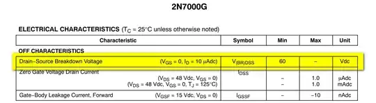

The choice of the symbol of the diode, rectifier vs. Zener, is somewhat arbitrary. The Zener symbol is chosen, most probably, to highlight the fact that, even when the MOSFET is OFF, there is a limitation on max Vds because of that diode entering breakdown. Many devices are characterized in that sense. See for example the 2N7000 datasheet I linked above (yellow emphasis mine):
As with any diode, bringing the device into breakdown put you at risk of damaging it. Entering breakdown is not in itself harmful, but in that region the current increases very quickly and the dissipated power consequently, too.
Actual Zener diodes are well characterized and their breakdown voltage is specified with a well defined range, therefore you can always control and limit the current so that the power doesn't exceed the max ratings of the device.
In a MOSFET, or other non-Zener diodes, the BD voltage is usually given as a minimum value, i.e. they give you that value so as to guarantee a maximum safe value for Vds. They don't specify a max BD-voltage value. This means that, taking that 2N7000G as an example, you may enter breakdown at (say) 60V , 70V or even at 80V.
Therefore you have no means, reading the datasheet, to guarantee that the power dissipation is under control: if you apply 65V, for example, you could have barely entered BD, so that the VI product is smallish and can be handled by the device, or you can be in full BD, where the current is huge and the VI product exceed the device ratings.

  • I've noted that the diode is usually shown as a Zener diode. Is this just to show that it has a particular reverse-bias breakdown voltage? Will reverse breakdown damage the device? – whitegreg56 Feb 05 '18 at 16:06
  • Thanks this helped. I would also like to know what it means when the MOSFET symbol has a zener diode instead? @LorenzoDonati – Devansh Mittal Feb 06 '18 at 05:11
