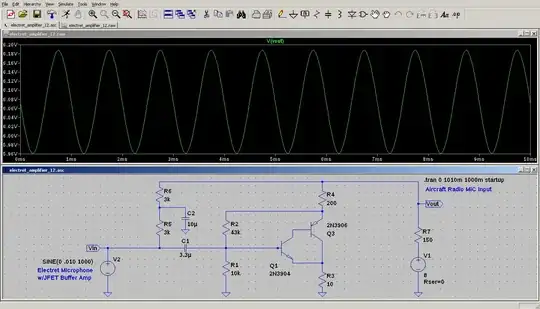

Electret amplifier LTSPICE I am trying to build an amplifier to allow a cheap electret boom microphone to be used with an aircraft radio, but am unsure how to increase the gain to a usable level.
I derived the attached design from experimentally trying this Circuit to make an electret microphone simulate a carbon microphone and Andy AKA's electret microphone amplifier design, neither of which had sufficient output when tested in the aircraft, and experimenting with schematic changes and component values in LTSPICE.
The attached design works though the output is lower than required when using a normal voice, but when speaking very loudly the output level matches the output level of commercially available aviation headsets and the signal is still very clear and intelligible. This tells me this amplifier can easily drive the aircraft radio's input but lacks sufficient gain to be driven by this microphone.
My previous attempt used a single 2N3904 (measured hFE = 110) and had the same problem of low output. Replacing the 2N3904 with an MPSA13 darlington (hFE = 5000) had no noticeable effect on the amplifier gain. I don't know enough about this stuff to understand why. How can I increase the amplifier gain without adding another transistor stage before the MPSA13? Cost isn't a factor but component count is as this amplifier will need to be made much smaller, and it seems absurd to require another stage when the MPSA13's gain is already so high. What am I missing?
I don't have access to an oscilloscope to measure actual signal levels and can only test each design in the aircraft, so there's a lot of guesswork involved. Any help will be greatly appreciated.

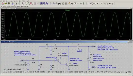

@Olin Lathrop - I simulated your amplifier design in LTSPICE (see image) Amplifier as suggested by Olin Lathrop

  • *Replacing the 2N3904 with an MPSA13* That's because hFE is the current gain which has almost **no influence** on the small signal gain of a transistor. To understand that you need to follow a course on transistor circuit analysis. My advice: get a different microphone/headset/amplifier because modding an existing one is nearly impossible when you don't fully understand transistor amplifiers. And learning how they work will take you even more time. The extra difficulty in an aircraft is the high noise levels of the engine, some kind of AGC is probably needed. – Bimpelrekkie Feb 03 '18 at 22:24
    Thank you for pointing out that hFE has little influence on small signal gain, that explains why the MPSA13 didn't help. I'm stuck with the microphone and radio, so modifying the amplifier design is my only option. The noise level is actually low because it's a jet aircraft so AGC isn't needed, and the microphone is a dual port noise cancelling type. – Adam Feb 03 '18 at 22:28
  • Small size doesn't require discrete components (individual transistors.) Integrated amplifiers are available in packages smaller than a single 2N3904. You have two things you need to do. One is to amplify the microphone, and the other is to drive the low impedance microphone input of the radio. I think you problems are in the amplifier section. A simple opamp microphone preamplifier can be made to provide enough gain and a high input impedance. That can then drive another amplifier with a low output impedance – JRE Feb 03 '18 at 22:30
  • Thank you JRE, however the problem is that the aircraft radio is intended to only supply a very small current (maybe 0.5mA?) to power the FET amplifier in an electret microphone, and a separate battery to power the amplifier is not an option. The amplifier needs to simulate a carbon microphone as that is the standard aircraft radio input (even in 2018!). The attached design has been demonstrated to do this, but lacks gain. My problem is how to increase the gain. – Adam Feb 03 '18 at 22:34
  • A better amplifier doesn't need to use more power. The odds are very good that an opamp preamplifier will use less current than your single transistor amplifier. – JRE Feb 03 '18 at 22:42
  • Will powering the opamp from Vout (see schematic) cause any problems? This will not be a steady DC voltage, the radio input thinks it's applying DC to a variable resistance carbon microphone... – Adam Feb 03 '18 at 22:46
  • Why would it be a problem? You are powering your transistor amplifier the same way. – JRE Feb 03 '18 at 22:53
  • I'm not sure why... in the transistor amplifier the transistor is intended to behave as a variable resistor with resistance a reasonably linear function of the microphone signal... don't most opamps get upset when they don't have a steady DC supply voltage? – Adam Feb 03 '18 at 23:23

  • I simulated your amplifier design in LTSPICE (see image) and found the output to be very low, well below the 0.5-1.0V p-p expected by the aircraft radio. I tried removing the 10R resistor and/or decreasing the 200R resistor to 20R and both increased the output to around 1V p-p, but the gain is about the same as the amplifier I posted first and the two other designs referenced in my original post. I still need to find a way to increase overall gain about 5-10x to accomodate the low microphone output (I'm simulating 10mV but think it might be closer to 1mV in practice). – Adam Feb 04 '18 at 17:39
