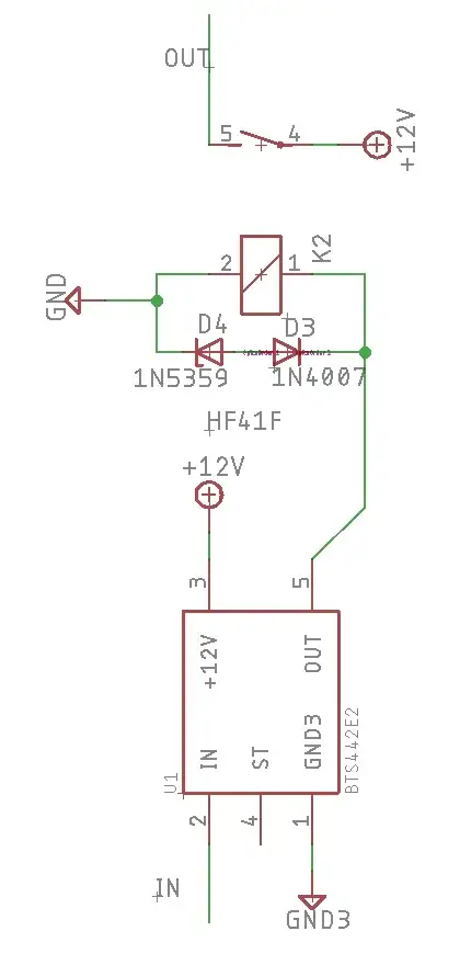

3V3_TO_12V Module
3V3 to 12V converter
This module converts the 3.3V GPIO output from the BBB to a 12V signal on the other side. When the 3.3V signal is low, the 12V signal is low. When the 3.3V signal is high, the 12V signal is high.
To do this, the 3.3V GPIO output is connect to a high side power switch, which turns a 12V SPST relay on and off. This switches the 12V power as output of the module to be used elsewhere.

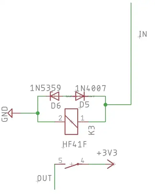

12V_TO_3V3 Module
12V_TO_3V3 Module This module converts a 12V signal to 3.3V signal, to be read by a GPIO input from the BBB on the other side. When the 12V signal is low, the 3.3V signal is low. When the 12V signal is high, the 3.3V signal is high.
To do this, the 12V signal simply turns a 12V SPST relay on and off. This switches the 3.3V power to be read as input by the BBB.

  1. Is the high side power switch and 12V SPST relay combination overkill for having the BBB GPIO output control the 12V power line? I like the isolation and safety it provides, but it seems too much (in terms of cost and board space)
  2. Is there a better solution for the 12V to 3.3V conversion. I like the simplicity of the 12V SPST relay switching a 3.3V signal, but it takes up lots of room.

  • Old question I realize, but: The model of those relays whose coil runs from 12V only requires 75mA, not 3A. You can easily switch that from the BBB with a single transistor. If you need isolation between BBB and the relay coil, you can use an optoisolator driving a transistor to switch the relay. For input (ie: 12V --> 3.3V --> BBB), just use an optoisolator, no relay required or useful. – gwideman May 02 '19 at 23:07

  • "I like the isolation and safety it provides" In general we only purposely add galvanic isolation when it adds something. You need some specific requirement like "the secondary is definitely dangerous" (like 230VAC) or "the customer can't be trusted to provide a clean ground" and similar. Otherwise it is not necessary. As for the high side driver, it is completely overkill - these parts are used for relay _replacement_ not for driving relays - any standard MOSFET can do that. And do you really need these high currents? – Lundin Feb 07 '23 at 12:28
  • Question 1: I think you could do this with a logic-level FET with appropriate current rating (if you don't mind the inversion - or two FETs - one small signal and one power FET to get rid of the inversion. ) Question 2: Yes, a divide by 4 (approx) voltage divider. Two resistors. – Troutdog Jun 07 '23 at 17:13
An optocoupler ( 4N25 for example ) can provide both isolation and level translation, and it is much cheaper and smaller than a relay. For 12V->3.3V translation it is just an optocoupler and two 1k ohm resistors. One resistor to set LED current to 10mA ( roughly ) and the second one to act as a pull-up ( inverting configuration ). The base terminal can be left open. Connect output transistor as an emitter follower if non-inverting configuration is needed. 3.3V to 12V translation is more complex. BBB may not be able to source current required by the optocoupler so a small n-channel MOSFET will be needed on the input side, and to provide 3A to the relays a p-channel MOSFET should be connected to the output of the optocoupler ( along with a 10k pull-up resistor )
