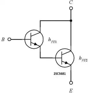

First, i planned to put an npn transistor before the 2SC5681 in a darlington configuration to amplify the current gain. Like this
but when I reviewed the 2SC5681 datasheet, i saw that this transistor needs a positive Ib (which is normal) AND a some negative current at the base for switch off (fast) In Red
so my question is, can i use the darlington configuration to achieve the base drive despite this negative current? or what kind of simple base driver can i use for this transistor?

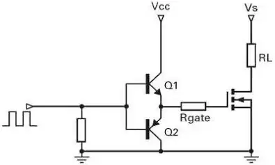

I had thought of using a push pull configuration like a mosfet gate drive system but is it adapted?
push pull gate drive ?

  • Your proposed drive circuit is not going to be very effective at sucking charge out of the BJT base unless you drive it below ground and connect it to to a negative supply. – Spehro Pefhany Feb 01 '18 at 21:30
  • Welcome to EE.SE. Use the push-pull circuit as it is dependable and a common solution. Base drive current should be limited to 5 mA if using 2N3904 and 2N3906. Rgate is usually 22 to 33 ohms. Vcc cannot be more than 15 volts. –  Feb 01 '18 at 21:30
  • @SpehroPefhany. OP should put a 1N4148 diode on Rgate for that reason. Anode to mosfet gate. –  Feb 01 '18 at 21:32
  • Why does your first circuit have Vcc at 200 volts? Must be a typo. –  Feb 01 '18 at 21:34
  • @Sparky256, presumably he had a reason to choose a transistor with 800 V \$V_{CEO}\$. – The Photon Feb 01 '18 at 21:46
    BTW, searching this part and finding it distributed by Rochester and not Digikey/Mouser makes it likely this part is at or beyond end of life, and if you are planning to be able to reproduce this circuit in the future you might want to find a different transistor. – The Photon Feb 01 '18 at 21:48
  • @Sparky256 add a diode didn't create a negative current, because the transistor i use is not a mosfet so there i no stored energy in the gate. no? i thinks i need to apply a cuurent – Maxime Loiseau Feb 01 '18 at 22:06
  • @SpehroPefhany you're right ! so if i create a negative power supply is it possible ? or if i put a high capacity capacitor in serie with the Rgate, so the caps after charging by the positive voltage, will discharge (through the low transistor) and create a negative current in the gate ? – Maxime Loiseau Feb 01 '18 at 22:06
  • @MaximeLoiseau I think the capacitor in parallel with the base resistor (maybe with a series resistor to limit the peak current) is a capital suggestion. – Spehro Pefhany Feb 01 '18 at 22:13
  • @Sparky256 how did you choose Rgate value ? for a 1-2A base current ? – Maxime Loiseau Feb 01 '18 at 22:13
  • @SpehroPefhany not in serie ? in serie with base resistance , because that resistor will limit the current ? – Maxime Loiseau Feb 01 '18 at 22:18
  • @MaximeLoiseau. No. It is common to have a gate resistor on a MOSFET to dampen ringing and overshoot at the drain. A 1N4148 bypass diode would be good to turn the gate off faster. The sharper the gate rise/fall times the more efficient it will be. –  Feb 01 '18 at 23:42
  • I am confused. The OP is talking about an ancient Darlington but showing us a MOSFET and its driver. –  Feb 01 '18 at 23:51
  • @Sparky256 Right, and he really wants to drive a high voltage power transistor. – Spehro Pefhany Feb 02 '18 at 01:15
  • @Sparky256 I want to drive the 2sc5681 (a BJT not a mosfet !), and i search the better way to do that, in consideration that the 2sc5681 need a negative current to switch off. so i had thinking to use the same system for drive a mosfet (just by using the push pull, not the mosfet) – Maxime Loiseau Feb 02 '18 at 11:33

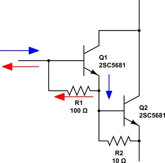

When transistors are used in Darlington configuration they are usually used with resistors R1, R2 to allow the driver to provide the reverse recovery current to Q2 and to prevent leakage (amplified by \$\beta^2\$) from turning on the transistors.
