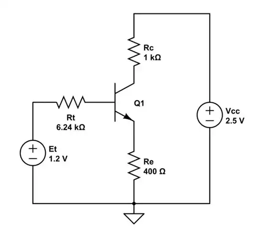

Let's say we have the following circuit: enter image description here
The known values are: \$\beta=100\$, \$Vcc=2.5V\$, \$V_A=\infty\$ (meaning the Early effect is not taken into account), \$V_{BE}=0.7V\$, \$I_S=8\cdot10^{-16}A\$ (which is the reverse saturation current of the base–emitter junction), \$Rc=1k\Omega\$, \$R_E=400\Omega\$, \$R_1=13k\Omega\$, \$R_2=12k\Omega\$.
If we assume that the transistor is opperating in active mode, and the Early effect is not taken into account, we can calculate the collector current by: $$I_C=I_S\cdot e^\frac{V_{BE}}{V_T}$$ where \$V_T\$ is the thermal voltage of approximately \$26mV\$. All the values are known and we get: $$I_C\approx0.394mA$$ However, let's say we won't use that formula and we won't assume the transistor is in active mode. We can find the Thevenin equivalent of the base voltage as: $$Et=\frac{R_2}{R_1+R_2}Vcc=1.2V$$ $$Rt=R_1||R_2=6.24k\Omega$$ Now the equivalent circuit looks like this: enter image description here
If we apply the second Kirchhoff law to the left contour, we get:
$$Et-Rt\cdot I_B-V_{BE}-Re\cdot I_E=0$$ Since \$I_B=\frac{I_C}{\beta}\$ and \$I_E=\frac{\beta+1}{\beta}I_C\$, we get:
$$Et-Rt\frac{I_C}{\beta}-V_{BE}-Re \frac{\beta+1}{\beta}I_C=0$$ $$I_C=\beta\frac{Et-V_{BE}}{Rt+Re(1+\beta)}\approx 1.07mA$$
As we can see, we get different results. Where did I make a mistake in my calculations?

Consider the equation that uses the reverse saturation current
And then consider what happens for a slight difference in Vbe: -
  • If Vbe = 0.70 volts then Ic = 0.394 mA
  • If Vbe = 0.68 volts then Ic = 0.183 mA
  • If Vbe = 0.72 volts then Ic = 0.851 mA
So choose Vbe carefully or you'll be a mile out.
If you chose Vbe to be 0.72597 volts, Ic would equal 1.07 mA and match your 2nd derivation. It's easy to get fixated on what you believe are correct numbers.
As for the 2nd derivation using Kirchoffs, there is an omission that is relevant and will slightly lower the collector current. The omission I refer to is called \$r_E\$ and is the internal emitter resistance.
In simple terms it equals \$\dfrac{V_T}{I_C}\$
Or about 26 ohms for an \$I_C\$ of about 1 mA and is fairly significant when you consider that \$R_E\$ is only 400 ohms. So, it's best not to get too fixated on some formulae. I'd be interested to know what a sim produces.
  • So, if Vbe is exactly 0.7V and reverse saturation current is given, and on the other hand, beta is set to be 100, can we say that both ways are correct, but contradictory? – A6EE Feb 01 '18 at 12:14
    Clearly Vbe is not 0.7 volts. However, you can home in on its value by using the two methods and, when they are in agreement you have an improved value for Vbe. If I assume 0.7 volts I get (by my approximation) a collector current of 1.25 mA. If I assumed Vbe to be 0.8 volts I get a collector current of 1 mA. Using the first method and Vbe of 0.8 volts yields a collector current of 18.5 mA. It's not an exact science. – Andy aka Feb 01 '18 at 12:19
You have a bunch of undefined terms in your equations, especially the first set. So we can't tell exactly what you are doing.
It seems you are using two different models for what the transistor will do, and not surprisingly, they have the transistor doing different things. The second model seems to be assuming a fixed gain of 100, which matches your initial verbal description. However, the first model isn't following that. The undefined terms make it unclear, but you have the collector current as a function of the B-E voltage, which is clearly not using a fixed gain approximation.
Olin Lathrop
  • 310,974
  • 428
  • 915
    @A6EE: In your context, you'd have to tweak the coeficients of the first model so that you get a gain of 100 at exactly 700 mV Vbe. However, the system might still find a different stable operating point where Vbe is not 700 mV and the gain is not 100. – Olin Lathrop Feb 01 '18 at 12:16
