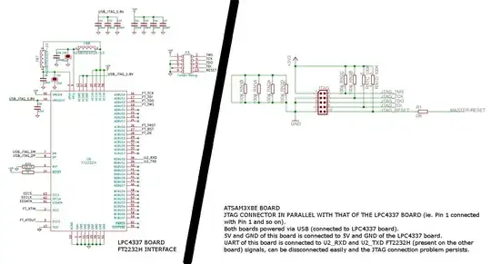

These are the JTAG interface schematics of both boards that were connected together. The flat cable is connecting Pin1 of "P3" connector on LPC4337 board schematic with Pin1 of "JTAG" connector of ATSAM3X8E board schematic, etc. (All 10 pins connected accordingly, tested with continuity with a multi-meter). enter image description here This is LPC4337 board schematic.
This is ATSAM3X8E board schematic.

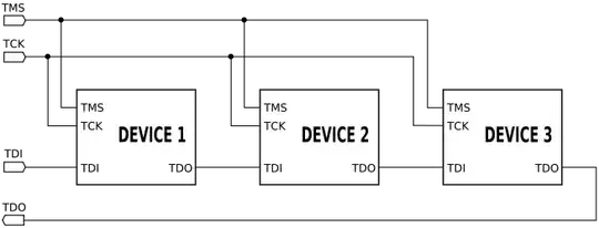

Thanks to the answers I found out I was using a star JTAG topology but a daisy chain JTAG topology would be the standard approach. I will change my wiring and post my results. Thanks for the help. This will be my wiring topology (but with two devices): New topology
EDIT 3:
JTAG was changed from a star topology to a daisy chain topology. LPC4337 TDO is routed to the connector and eventually to ATSAM3X8E TDI. ATSAM3X8E TDO connects via the connector to the FT2232H interface. When no device is connected and only the LPC4337 is being programmed, a little male connector (pictured below) can be plugged (instead of the cable) and bridges LPC4337 TDO directly to the FT2232H interface. New setup OpenOCD connection succeeds and outputs the following:

    I'm not an expert but don't the ports need to be wired in a daisy chain using TDO and TDI? – Andy aka Jan 29 '18 at 14:03
  • Andy aka, I guess they kind of are. Wouldn't connecting all JTAG connector pins together be what you mean? Would you wire them differently? When LPC4337 JTAG traces are cut ATSAM3X8E JTAG interface starts working so I guess the wiring is correct. But maybe it isn't. Please feel free to suggest a different wiring strategy. I have cut and rewired LPC4337 JTAG traces more than once, and every time the traces are cut ATSAM3X8E interface works, and stops working when traces are rejoined. Please, if you know something about my TAP ID questions let me know. Thanks in advance! – Juan Manuel López Manzano Jan 29 '18 at 14:36
  • Andy aka, I now see what you meant, thanks for your help. I'll try a daisy chain topology instead of a star topology and post back – Juan Manuel López Manzano Jan 29 '18 at 15:13
The comments suggest you are trying to operate in 'star topology', but as far as I know, that isn't a well defined implementation.
Please confirm you're using daisy chained topology, where the multiple TAPs make up a single long shift register. Debug tools ought to cope with this since it sometimes occurs implemented in a single chip.

    Daisy chain is well supported. Star topology requires that the TDO pins are tri-stated when a TAP is inactive (and I can't think off hand how the selection would work). You're trying to use STAR. It won't work. – Sean Houlihane Jan 29 '18 at 14:48
  • Thank you for the TAP ID clarification. I guess there shouldn't be any problems with a repeating TAP ID as long as OpenOCD is configured to "tap" all chips in the order they end up presenting. (I also tried "taping" the ATSAM3X8E before the LPC4337 but didn't work and in my particular implementation LPC4337 M4 ARM core seems to always be the first core detected, followed by the LPC4337 M0 and lastly the ATSAM3X8E M3) – Juan Manuel López Manzano Jan 29 '18 at 14:50
  • "Star topology requires that the TDO pins are tri-stated when a TAP is inactive". So should I be turning TDO signal of a particular chip interface to high impedance while trying to connect to the other? The FT2232H chips output is connected to a buffer that allows tri-stating all signals (but for both chips) would the signals need to be individually tri-statable for each chip? – Juan Manuel López Manzano Jan 29 '18 at 14:53
    No, just use daisy chain. – Sean Houlihane Jan 29 '18 at 14:54
  • Searched for JTAG daisy chain interface and found that you were referring to connecting TDO of a given chip to the TDI of the next one. I'll try using that topology. – Juan Manuel López Manzano Jan 29 '18 at 15:04
