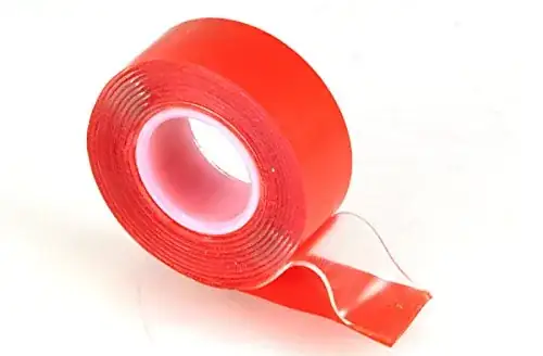

Double-sided tape has already been brought up, but I wanted to mention a particular type:
Acrylic tape
acrylic tape
  • Adhesion is very strong, and the tape is typically thick enough to allow protrusions to sink in. This allows it to hold against the uneven component heights, or even just the tips of pin headers.
  • Doesn't tear/flake like foam tape, which makes for easier removal.
  • Because it's clear, you can use it over LEDs, read silkscreens/components, or see if magic smoke has been released underneath.

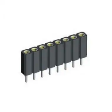

I've mostly used for exactly same applications arduino NANO shields with screwholes or I've made them. Both versions are showed below, but also consider using M3 spacers (M3 is unwritten standard for all electronics) and try to collect some different lenght spacers and different polarities (male-male, male-female, female-female), as they come very helpfull.
PS: Some chinese copies even have holes at the edges holes for M2 or M2.5 sc
And the way, you can make your own from soldering protoboard: just cut as the red line goes and drill the 3mm holes where the arrows show and for the same distance between those 2 holes, another 2 holes int othe plastic case. Below your new "shield", add 8mm (or more) M3 spacers and tighten the shield from both sides. When you solder those black female header pins, you don't need to connect them anywhere, they're there only for holding arduino down. enter image description here
female header pin: enter image description here
Jakey
  • 798
  • Sounds like a very good idea, I will check also for the spacers. Thanks – Michel Keijzers Jan 29 '18 at 17:07
    Thanks. Spacers are quite cheap, you can get 100pcs for about 5$ over the web. I'm using 10mm most often (female-female) and in 99.5% of my electronics, I use M3 screws. It's a good way to "standardize" your screws and nuts. That's why I keep about 50-60 different M3 screws (lenghts, heads, materials). – Jakey Jan 29 '18 at 18:55
    thanks ... yes I also going to order a set. This will not be my first project anyway. – Michel Keijzers Jan 29 '18 at 19:49
  • How are those black things called around the pin headers? I think Dupont housing (same like used for dupont cables)? The black surroundings for the pins between the pins of the MC board and the soldering board? – Michel Keijzers Jan 29 '18 at 20:36
    They are called "female header pins". I've corrected my answer to show you photos of them. – Jakey Jan 29 '18 at 21:55
  • Thanks (again)... I should have known, since I have the male version of them. I think it might be worthwhile ordering some female versions as well. – Michel Keijzers Jan 29 '18 at 22:04
    Yes. Also consider buying "extended header pins" in case you will be doing arduino shields for etc. Uno or Mega2560. Shields are stacking one onto another easier. Also you could buy "professional header pins", but I personally don't like to use them. Never did. – Jakey Jan 29 '18 at 22:38
  • Thanks ... actually I started (not this project) using Arduino's, however, I soon found out the Arduino's are too 'light', and found the STMs which have better specs (and cheaper). But maybe I might use some kind of STM shields so that's a good idea. – Michel Keijzers Jan 29 '18 at 23:12
  • Doesn't matter. If only needed to play with 1 relay - it doesn't matter what you use. Nowadays electronics is so cheap, it doesn't matter which company you pay for uC. – Jakey Jan 29 '18 at 23:58
