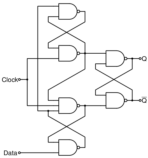

A D-Type Flip-Flip can be the simple...
to the more complex Edge Triggered D-Type Flip-Fop like the 74xx74 device.
In the simple case the clock line more acts as an enable than an actual clock. As you should be able to see, when the clock line is high the Data line is passed through to the S-R latch and changing it while clock is high will change the outputs. In my opinion, the circuit is actually more of a transparent latch.
In the more complex edge triggered device, the extra flip-flops prevent this and the output latch is only set on the rising edge (in this case) of the clock.
For both circuits the final state depends on the timing of the data and clock edges. In some cases the output can actually oscillate due to metastability. The other answers here have covered those requirements in detail so I will not expand on that further here other than to say changing C and D at the same time is a bad idea and will produce unpredictable results.
