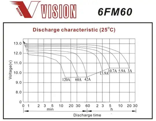

Here are some typical discharge curves for AGM lead-acid, in this a case a 12V 60AH battery (40Ah should be similar but with all currents multiplied by 40/60):-
Note that the time scale on this graph is logarithmic so the curves are a bit deceptive. However you can see that as current increases voltage reduces, and capacity is reduced at high current (eg. at 60A it lasts 30 minutes which is only 30Ah). So you can use voltage to estimate remaining capacity, but to get reasonable accuracy the effect of current draw must be factored into your calculations.

Capacity may be reduced due to shedding of active material from the plates, electrolyte loss, sulphation, impurities or contamination etc. Some of these things also increase internal resistance, causing greater voltage drop at higher current.
Capacity loss may occur suddenly and cannot be reliably predicted, so to get the actual capacity you need to measure it. The obvious method is to fully charge the battery and then discharge it until empty. Alternatively you could just discharge until you reach the minimum working voltage in your system at normal current draw, as this is the effective capacity in your application. If only done occasionally this calibration cycle should not significantly affect lifespan.
You can measure internal resistance by applying or waiting for a step change in current, then calculating resistance from the voltage difference. This figure can then be used in the calculations you do to estimate remaining capacity.

  • Thanks Bruce, that clarifies my understanding a lot. Seems that measuring capacity is much more complicated than I thought. And as for the other point, I note from your explanation that actual capacity measurement still requires occasional 'full' discharge of the battery. You mentioned about the need to factor in current draw in my calculations? Are there any algorithms available for this? – Craver2000 Jan 23 '18 at 06:35
  • The reason for me asking is that if the current draw from my load varies from time to time, then subscribing to one of the logarithmic curves (with fixed current value) shown above may not be accurate anymore. – Craver2000 Jan 23 '18 at 06:35
  • The curves are not actually logarithmic, they just look that way because only one axis is logarithmic. Voltage drop during discharge is relatively linear until the battery is almost flat, so a linear extrapolation may be good enough. The effect of current draw can be included by modeling internal resistance and adjusting capacity to match the known battery characteristics (if you don't have data for your battery then use the graph above). How complicated it gets depends on what accuracy you want - many would be happy with 5 'bars' showing approximate percentage of charge remaining. – Bruce Abbott Jan 23 '18 at 07:13
  • You can't tell what the actual capacity is until you discharge the battery. At full charge the voltage will always be maximum, no matter what the capacity. As you discharge the battery the current and voltage drop can provide an estimate, which gets more accurate the closer you get to full discharge. After measuring capacity you may assume that it probably won't vary significantly short term, but long term it will (thus the need for occasional capacity checks). Or you could just show the capacity left as a proportion of full capacity (_whatever_ that is). – Bruce Abbott Jan 23 '18 at 07:24
