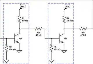

Just for review, let's start with the following schematic. There are two BJT sections, with their outputs coupled to the opposite section's input via a resistor:
In effect, each section is an inverter with a weak pull-down at the input. As connected, the circuit is bistable in the sense that if the left stage's input is taken as LOW, then its output is HIGH and forms the input for the right stage. Since the right stage has a HIGH input, it's output is LOW. This matches up with our assumption, so it is stable. We can work through the opposite logic and arrive at opposite but stable results. So while we cannot say which stable circumstance actually happens, we can say that it appears on the surface that some stable condition will result.
Slight variations in components and parasitics will probably determine which of the two stable situations results, if this were placed on a protoboard or otherwise wired up. But it should be fine.
On a more quantitative level, we can see that the voltage value of a LOW at the input of a stage will be about \$\frac{2}{3}V_{CE_{SAT}}\$. That will usually be \$\lt 200\:\text{mV}\$ with a series impedance of about \$32\:\text{k}\Omega\$. While not exactly reverse-biasing, this really should be low enough in order to keep the following BJT essentially "OFF". (There might be a tiny residual collector current enabled by this setup, but not enough to develop any meaningful voltage drop across its collector resistor.)
Similarly, the voltage value of a HIGH at the input of a stage will be about \$\frac{2}{3}V_{CC}\$ with a series impedance again of a very similar \$34\:\text{k}\Omega\$. The base current will therefore be about \$I_B=\frac{V_{CC}}{50\:\text{k}\Omega}\$. This implies that any \$\beta\ge \frac{50\:\text{k}\Omega}{3.9\:\text{k}\Omega}\approx 13\$ is sufficient here to allow a HIGH input to generate a fully LOW output.

Note that in the way I drew out the first schematic here, I teased apart what otherwise looked like a single, tightly connected circuit into two distinct sections (inverter stages) that were connect to each other via a very simple resistor.
