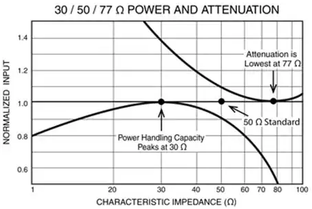

Some impedances are more suited to higher power transmission and some are more suited to producing lower losses: -
Diagram taken from Techplayon but is available from other sources. The one below is taken from Beldon's website: -
So, 50 ohms is a compromise between low loss and decent ability to pass power.

The 50 Ohm system originates in a trade off between loss and power capability of a coaxial cable.
You get the minimal loss at approximately 75 Ohms Impedance. However, the maximum power capability is achieved with approximately 30 Ohms.
This is due to the different dimensions of the coaxial line at different impedances.
As a result 50 Ohms were chosen as a tradeoff.
