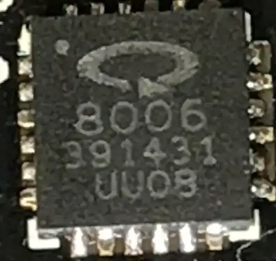

I'm trying to identify the manufacturer and component from a Belkin tunecast (Lightning) to FM transmitter device. I've searched through a couple of logo sites and Google and was not successful.
The part number being only numbers does not help either :(
Grainy image of chip with logo (arrow bent into a circle) and numbers 8006, 391431, UU08

    As usual, context would help. – Marcus Müller Jan 16 '18 at 08:32
    As Marcus says. We need to know where you found the chip (what product), more details on the surrounding circuitry (a photo), and possibly even an approximate dimension. – Tom Carpenter Jan 16 '18 at 08:42
  • This is in a Belkin tunecast (Lightning) to FM transmitter device. I figured for identification purposes (especially the logo) context would not matter. I'll remember next time to add more information. – allgoodnamesaretaken Jan 16 '18 at 13:02

It's a Quintic QN8006B High Performance Digital FM Transceiver in a QFN-24 type package.

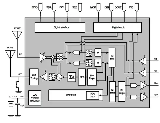

QN8006 Functional Block Diagram Image from datasheet linked above.

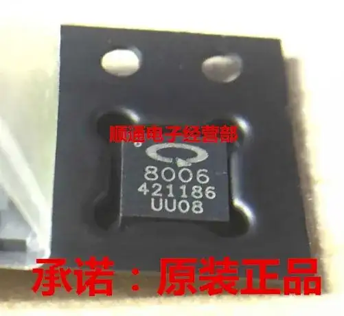

For confirmation, here is a picture of one: enter image description here
Image Source
