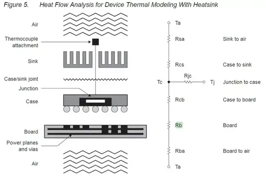

Some of this heat propagates upwards, but some must also go downwards towards the PCB. I don't know the ratio.
That's true, heat propagates in all directions. Unfortunately, the rate of propagation (also known to be characterized as thermal resistance) is very different.
A CPU must be connected with peripherals/memory somehow, so it has 1000 - 2000 pins for that purpose. So the electrical path (fanout) must be provided, which is done via printed circuit board technology. Unfortunately, even if impregnated with bunch of copper wires/layers, the whole PCB thing doesn't conduct heat very well. But this is unavoidable - you need connections.
Early CPUs (i386-i486) were cooled mostly via PCB path, in early 90-th the PC CPUs had no heat sink on top. Many chips with traditional wire-bond mounting (silicon chip on the bottom, pads connected with wires from top pads to lead frame) may have thermal slug on the bottom, because this is the path of least thermal resistance.
Then the flip-chip packaging technology was invented, so the die is on the top of package, upside-down, and all electrical connection is done via electrically conductive bumps on the bottom. So the path of least resistance is now going through the top of processors. That's where all extra tricks are used, to spread the heat from relatively small die (1 sq.sm) to bigger heat sink, etc.
Fortunately, CPU design teams include sizable engineering departments who conduct thermal modeling of the CPU die and entire packaging. The initial data came from digital design, and then expensive 3-D solvers give overall picture of heat distribution and fluxes. The modeling obviously includes thermal models of CPU sockets/pins and mainboards. I would suggest to trust them with solutions they provide, they know their business. Apparently some extra cooling from the bottom of PCB just isn't worth extra effort.
ADDITION: Here is a lump model of a FBGA chip, which can give an idea to, say, LGA2011 Intel thermal model.
While the multi-layer PCB with thermal vias and 25% copper content might have somewhat good thermal performance, modern/practical LGA2011 system has one important element, a socket. The socket has a needle-type spring contacts under each pad. It is quite obvious that the total bulk of metal contact across the socket is quite smaller than the bulk copper slug on the top of CPU. I would say it is no more than 1/100 of the slug area, likely much less. Therefore it must be obvious that the thermal resistance of LGA2011 socket is at least 100X of the top direction, or no more than 1% of heat can go down. I guess for this reason Intel thermal guides totally ignore the bottom thermal path, it is not mentioned.

A response that hasn't been given yet is because of the way they are built. CPUs used in computers and laptops are (at least to my knowledge) never a full flip-chip. They simply have too much connections to allow easy flip-chip on a simple PCB process used on motherboards. I mean simple here compared to the processes needed for RF/millimeter wave applications, or a process that allows densities where you really can fan out 1000+ pins on a few square millimeters.
For this reason, CPU dies are always flip-chipped onto a interposer. This is often ceramic, and made out of many layers. Here is an example, from wikipedia. Yo can see 5 separate dies on this package, in addition to a large amount of small passives around the edges (from what I can tell this is actually a even more complex stack-up, with a silicon interposer to interconnect the different dies, and that is then put on top of a ceramic interposer).
Why does this all matter? You suggest that you must be able to efficiently transfer the heat through the pins on the CPU. However, this is not the case, because of this interposer. This is not like a big power device where the big metal bit is actually connected to the silicon - there is a lot of stuff in between.
As a result the thermal conductivity from the die to the pins is still low - so even if you were to find some very nifty way of getting all the heat away from those pins, you would barely see any improvement, since you will still be dealing with order-of-magnitude greater thermal resistance compared to a metal heat-spreader that is in direct contact with the top of the silicon.
If you go to CPUs used in phones or embedded devices, which a "bottom heatsink" pad, things are different. Here they don't use a flip-chip approach. In the center of the BGA, they will have a metal place on which the die is thermally attached (this is usually also ground). They then use bondwires to connect up all the pins, still using a form of interposer with the metal in the middle (or the center metal is just a bunch of vias straight through to get low thermal conductivity). This means that there is a lot less material between that center cooling pad and the BGA pins, allowing for far more efficient heat transfer.

In avionics, cooling is evaluated for all possible paths, including via the PCB.
A mainstream microprocessor in a laptop / desktop generally uses a mixture of conduction (heat sink) and convection (forced air usually) cooling. As the mixture of these two moves the majority of the heat away, the cooling mechanism via the PCB is sometimes ignored, but it is still present.
If equipment is in an unpressurised avionics bay, convection cooling rather loses meaning (the air density is very low meaning that there are insufficient molecules at high altitude to spread the heat). For that reason, conduction cooling is very widely used as it is the only truly effective cooling method in this scenario.
For this to be effective, numerous planes are used within the PCB as heat spreaders.
Where heat sinks are used (not a preferred solution but sometimes unavoidable), the path is still conduction cooled via heat ladders to a cold wall (this is a relative term - the cold wall may be at 70C or more).
Forced air is sometimes used, but within a pressurised chamber attached to the cold plate.
So in this scenario, cooling via all paths is utilised; conduction from both sides, FR-4 may not be particularly thermally conductive, but the copper planes are.
