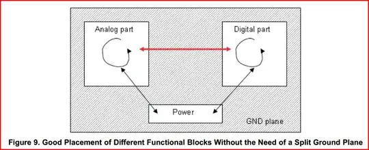

Another school of thought is to forget the inductor and split ground plane. Instead use a solid plane, but use careful placement and routing to ensure the digital/analogue signals stay in their respective portions of the PCB.
Layout
According to the figure below, you can see (for high speed signals) most of the return current flows very close to the trace (x is distance from centre of trace, h is trace height above plane):
Current Flow
No time to go into more detail right now (will try and add more later) but here are a couple of excellent links on the subject:
Henry Ott - Mixed Signal Layout
TI - High speed Layout Guidelines

    One way to get these values to basically 100% is to make separate nets for each of the sub-grounds, then connect them to the main ground plane in only one place. The main ground plane current then only carries the unavoidable return currents *between* the functional blocks, but not any of the potentially nasty currents within a block. – Olin Lathrop Jul 03 '12 at 16:09
    +1 for linking to Henry Ott's article. Jeanne, you should read that. – Rocketmagnet Jul 03 '12 at 16:16
