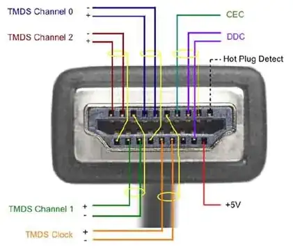

The same thing is happening on this circuit board. The immediately adjacent/close circuit board traces are "the pairs" and are kept the same length to allow the differential receivers to reject noise, although electrically rather than magnetically. You can see the HDMI connector carries several such pairs, and no attempt is made to keep one pair the same length as the pair next to it ("between pairs"). There are however some limits in the size of the elastic buffers (in bytes) after which the cable becomes non-operative or downgrades. It would be fun to experiment and find the limits in millimetres.
This picture of a HDMI plug shows the differential pairs: enter image description here

  • This is probably very basic, but searching hasn't really helped. What is a `pair`? If a pair is simply two different components then I don't understand the difference between `within a pair` and `between pairs` – George Duckett Jul 03 '12 at 15:01
    a 'pair' here just means two wires next to each other. A 'differential pair' is a way to send the same signal with opposite polarity, on the two wires, which allows you to cancel out any common-mode noise in the receiver. – shuckc Jul 03 '12 at 15:17
    @GeorgeDuckett: If one just sends a logic level on a single wire, then any currents that flow in that wire must return via the ground plane, and any noise picked up by the wire or the ground plane may affect the signal. To avoid those issues, high-speed signals are often sent using two wires (which I'll arbitrarily call "X" and "Y"); a logic "1" will be sent by driving X high and Y low; a logic "0" will be sent by driving Y high and X low. A device which is receiving the signals will interpret them as "1" any time the voltage on X higher than Y, and "0" any time Y is higher than X. – supercat Jul 03 '12 at 15:47
    @GeorgeDuckett: At any given time, current which flows out one wire will be pretty well balanced by current in the other, so the signals will not couple current onto the ground plane (which would be seen by other signals as noise). Further, any noise which appears on the ground plane from other devices will be seen roughly equally by both wires in the pair, and thus not affect which wire is "higher" at any given moment. – supercat Jul 03 '12 at 15:49
  • @shuckc: George Ducket wanted to know what the significance of a "pair" of wires was, since the way the wiggles are laid out does suggest that the wires go in pairs. I could have added that for a pair of wires to eliminate ground-plane currents, it's necessary that a rising edge on one wire and falling edge on the other arrive precisely simultaneously; even if logic could handle timing differences, it wouldn't be able to avoid the extra noise coupling that would result if the signals arrive at different times, but the answer already alluded to that. – supercat Jul 03 '12 at 16:17
