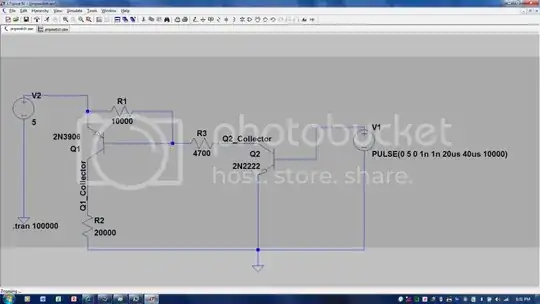

I am really confused about the attached LTSpice circuit behavior
LTSpice circuit
The voltage source V2 is simply a 5V supply and Voltage source V1 is a square wave of 40us period (5 volts)
I run the simulation - with the 5V square wave I would expect the Q1_Collector voltage to drop to 0 within 500ns of Q2 collector voltage going to 5 volts however the Q2_Collector voltage does not drop to 0 for 3us and I am trying to understand why.

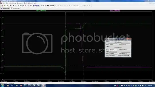

On the plot show below - I am plotting collector voltages at net Q2_Collector - in Green and voltages at Q1_Collector in purple - The cursors show how when the Q2_Collector voltage rises to 5Volts the Q1_Collector voltage does not switch off for almost 3us
Ltspice plot
I see from the data sheet that Q1 has a switch off time of 70ns and a storag time of 70~100ns. I created the circuit to model the switch off times and I noticed that the turn off times I observe in the simulation are of the order of microseconds (2-3) microseconds to be precise.

    Three things that would help: Make the schematic big enough to read. Label the nodes that you plotted so we know what the graph is showing. Make the graph using colors we can read (the dark blue is almost unreadable). – The Photon Jul 02 '12 at 21:49
  • What The Photon mentioned and make a small description about what you're doing, what you expect, and how the result differs. The sources (TRAN/PULSE) in the barely readable drawing are not very descriptive. Also include node numbers. The green line does remind me about the Miller platform a bit, but I doubt that can be it. – jippie Jul 02 '12 at 21:53

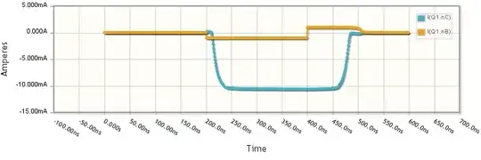

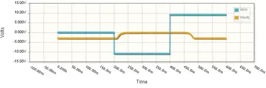

The test circuits for datasheet-quoted storage and turn-off times drive the base hard in reverse. In this datasheet, they drive the base-emitter junction to a 9V reverse bias through the 10K base resistor, so they basically go from 1mA out of the base (PNP forward bias) to 1mA into the base (PNP reverse bias). They do that "hard reverse" intentionally to extract the stored charge and get the BJT to shut off faster. If your circuit isn't so aggressive about it, the turn-off time will be a lot longer.

It takes about 80ns for Q1 to shut off (roughly from t=400ns to t=480ns), and that's with V1 pushing almost 1mA into the base (see the trace for "I(Q1.nB)"). If you change the piecewise-step source V1 to only go to 0 at 400ns, you'll find it takes far longer to shut off.
