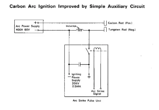

It would do something similar to this circuit: enter image description here
But instead of relying on a 20KV power supply, it would be preferable to use a low voltage supply
I'm trying to avoid any arc-circuit resistance beyond the arc itself and the negligible ESR of the ultracapacitor.
I find the aforelinked PDF description of the above pictured circuit somewhat confusing. It says the 20KV capacitor discharges through the inductor upon the Arc Strike Signal closing the switch -- but doesn't say anything about the timing of circuit in relation to the switch re-opening the circuit (which is presumably what causes the ignition spark). Moreover, why would it not be sufficient to dispense with the capacitor in this role and dispense with the timing problem by increasing the induction of the coil, lowering the Igniting Power Supply voltage and then closing and opening the switch at "leisure" to produce the magnetic field and then the spark as with an ordinary ignition coil? It's almost as if the description is off -- and that the capacitor is there only as a "snubber capacitor", to absorb the back EMF away from the Arc Power Supply.

I've done some work on a project with similar requirements, a DIY TIG welder. The crux of the issue are the contradictory requirements to deliver both high current at low voltage and low current at high voltage to the same electrodes. This is difficult, because you need switching devices which can block several kilovolts yet pass tens or hundreds of amps to do this in the naive way.
The typical solution appears to be discharging a high voltage capacitor to an inductor in series with the high current low voltage supply, as in OPs schematic. Usually this is done with a spark gap. As the energy rings down in the parallel LCR circuit thus formed, a high enough voltage to strike an arc is briefly present at the output. While conceptually simple, this has a few drawbacks:
  • It requires a high voltage power supply to charge the capacitor to several kV.
  • Arc initiation cannot be triggered exactly when required without substantial extra circuitry.
  • It's not solid state.
