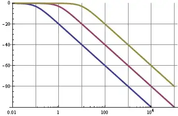

and a roll-off of 6 dB/octave = 20 dB/decade. The graph shows the frequency characteristic for a 0.1 Hz (blue), a 1 Hz (purple) and a 10 Hz (the other color) cutoff frequency.
So we can see that for the 0.1 Hz filter the 10 kHz fundamental of the PWM signal is suppressed by 100 dB, that's not bad; this will give very low ripple. But!

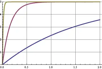

This graph shows the step response for the three cutoff frequencies. A change in duty cycle is a step in the DC level, and some shifts in the harmonics of the 10 kHz signal. The curve with the best 10 kHz suppression is the slowest to respond, the x-axis is seconds.

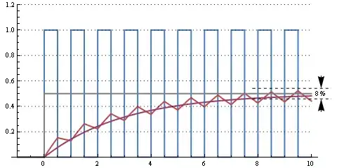

This graph shows the response of a 30 µs RC time (cutoff frequency 5 kHz) for a 50 % duty cycle 10 kHz signal. There's an enormous ripple, but it responds to the change from 0 % duty cycle in 2 periods, or 200 µs.

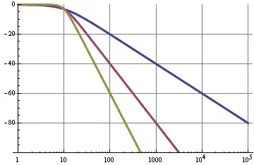

You can improve your filter by going to higher orders:
The blue curve was or simple RC filter with a 20 dB/decade roll-off. A second order filter (purple) has a 40 dB/decade roll-off, so for the same cutoff frequency will have 120 dB suppression at 10 kHz instead of 60 dB. These graphs are pretty ideal and can be best attained with active filters, like a Sallen-Key.
