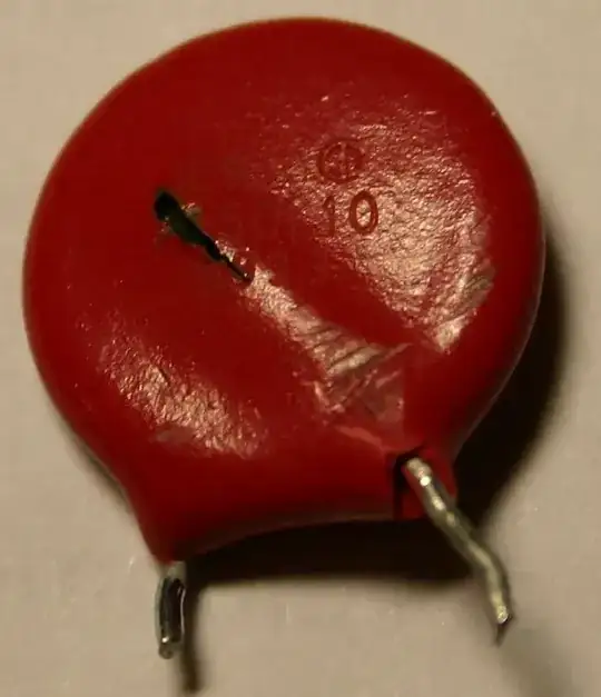

For example, if the device in your image is a sense resistor which has a low voltage across it, but it gets hot, so there is a gradient, you can keep the copper patterns on each pin of the resistor of similar area so the resistor is the same temperature at both ends, thus canceling out the thermoelectric voltages. It's only temperature differences that matter- not absolute temperature (otherwise the laws of thermodynamics would be violated since you would be able to generate power with no heat flow).
